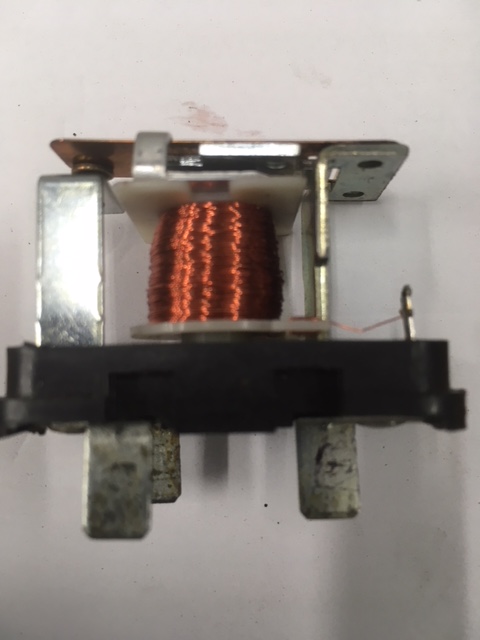

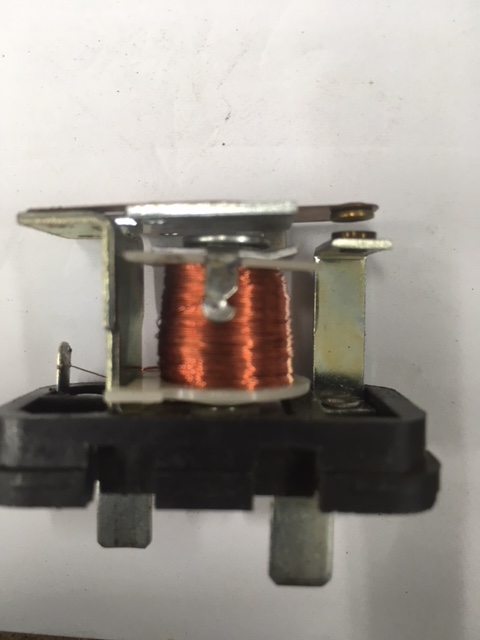

Would be interesting to understand why the OEM relay malfunctioned. (Curiosity hasn't killed me yet). Could be contaminated contacts but more likely the FINE wire wrapped around the electromagnet core, has broken. If you get curious perhaps you could let the forum know - just for sake of understanding. Took two pictures of a typical relay which are self explanatory.

It's the actual contacts. They're oxidized/corroded. I cleaned them once already, and cleaned them again with the relay out and got it working again. I'm just not willing to take the chance on it again.
