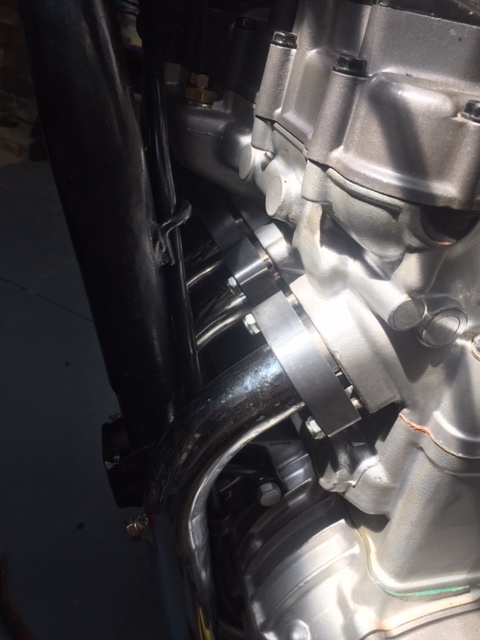

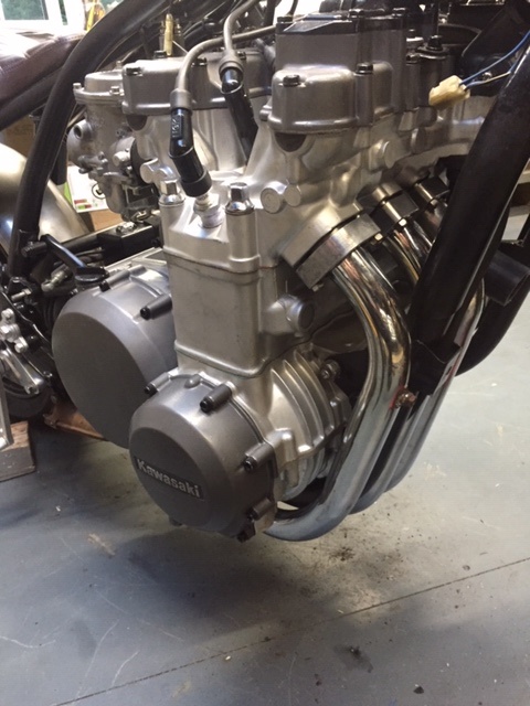

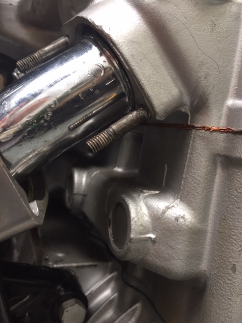

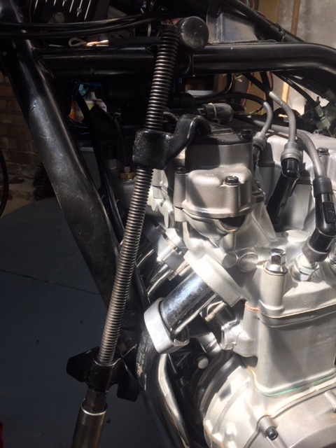

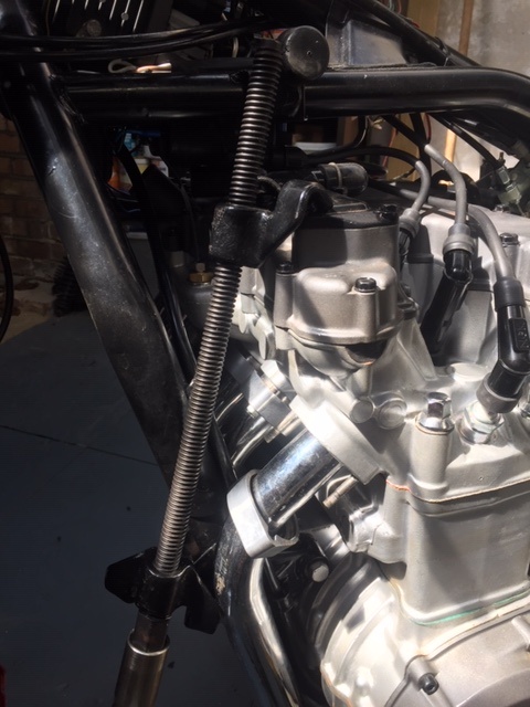

Clamp 'adjusted' (as in: removed) and five of the six pipes in/on. I also solved the one damaged stud.
However, stuck now: so near, yet so far! Last one WILL NOT go in enough to put the nuts on... It's sitting on the bottom lip.
I'll have to think of a way to lever it into place somehow - it already has a jack underneath so weight of the bike is already on it...

Maybe try loosening off the other 2 pipes going to the same 3 branch, and a bit of a wriggle.
It maybe just enough adjustment to lift it onto the lip / port ?
I always fit exhausts "loose" to begin with until all aligned, then tighten slowly once all good.

The two others are as loose as I dare (after stripping a nut previously) and the rear is also loose without the bolt alltogether.
The right went in no problem, this left one is somehow ... shorter, and so the collector box is hitting the rear bottom of the sump and that is just enough to not to give me enough room for the last pipe
I need to somehow lift and shove backwards this pipe...at the same time. Maybe a large clamp...
Otherwise, i'll need to take the whole thing off and maybe bend that particular pipe on the bench... and basho in the top front of the collector box a little to create room. Remember, this system only goes on until I can get my bespoke system made, so not too bothered about damaging it, and these boxes are pretty rusted, so really no use beyond my temporary intentions.

Ok, where there is a will (and a not-for-purpose tool that can be used) there is a way.
Last pipe is on.

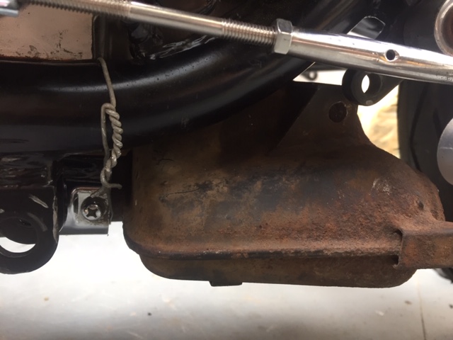

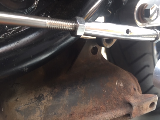

Main issue was that the pipe was welded to the collector box (not by me!) and it was a few mm too short. This meant the collector box is tight agains the rear of the oil sump. And that also means I cannot get the rear fixing bolt in as the two holes do not align. As it is temporary I have secured with a piece of coat hanger - it won't come loose. At least now when I have the air box fixed I can have a go at trying to start her up!
