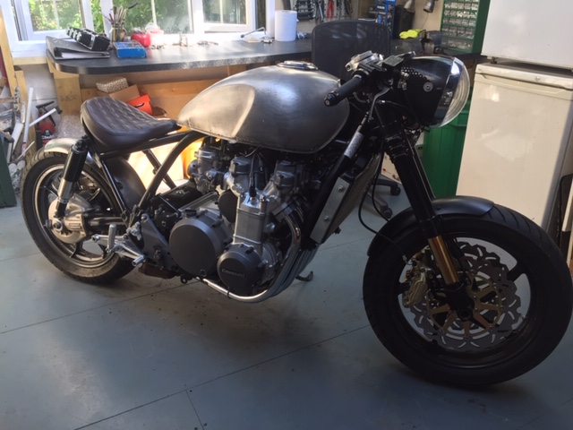

I took the carbs off to address the slight vacuum leak I had between the carb rubbers. I took the opportunity to reset the mixture screws - all 2.5 turns out. It idles nicely and revs as well, but sometimes the revs still 'hang'. RH side carb is also spitting back fuel through the air filter on occasion. I have ordered a synch set, so when that comes I'll do that and see if that makes it better. It starts on the button though!
Also awaiting Triumph UK to re-open so I can order the brushed aluminium seat pan I need for the bobber seat I have been given. Currently it is sitting a bit low and too far back.
Front brakes still a mystery, but overall its getting there!

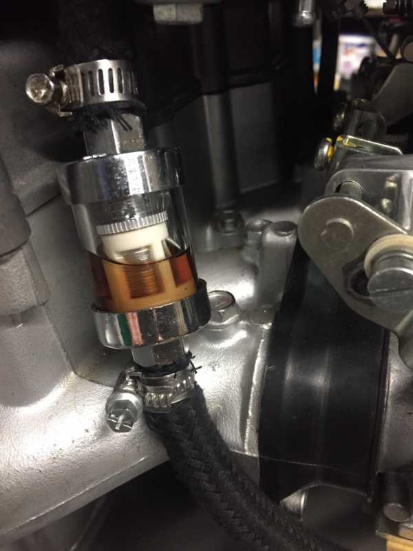

And here is another mystery? Colour change overnight of the petrol. It was clear yesterday and what’s in the tank is still clear.

Just a quick heads up. I had that exact same "Hi-Flow" fuel filter on mine and was plagued with running problems which I thought were down to the Suzuki vacuum tap I had installed. After putting a pingel back on I still had the same issues. When I checked flow from the fuel filter it was piss poor - a fraction of the flow rate without it. The bores in and out of the filter are of a reasonable size but the holes drilled through it to allow fuel to pass on either side of the filter are much smaller. I think this is because the hollow aluminum threaded center will be too weak if they were any larger?
Try fuel flow into a jar with and without that filter to be sure. I don't want anyone else tearing their hair out over a $10 P.o.S.

I have to jump-in on the fuel-filter ! I'll also confirm: This style, as politely pointed out, is CRAP !
I won't bother with further details and issues. Just get rid of it !
Use this one. No problems - no issues, and inexpensive. Avoid a typical screw clamp. Use the spring-clamps typically included as they provide full and even circumferencial clamping force and won't chew-up the fuel line.
