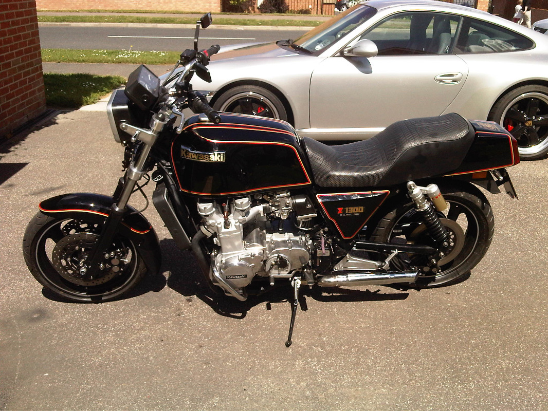

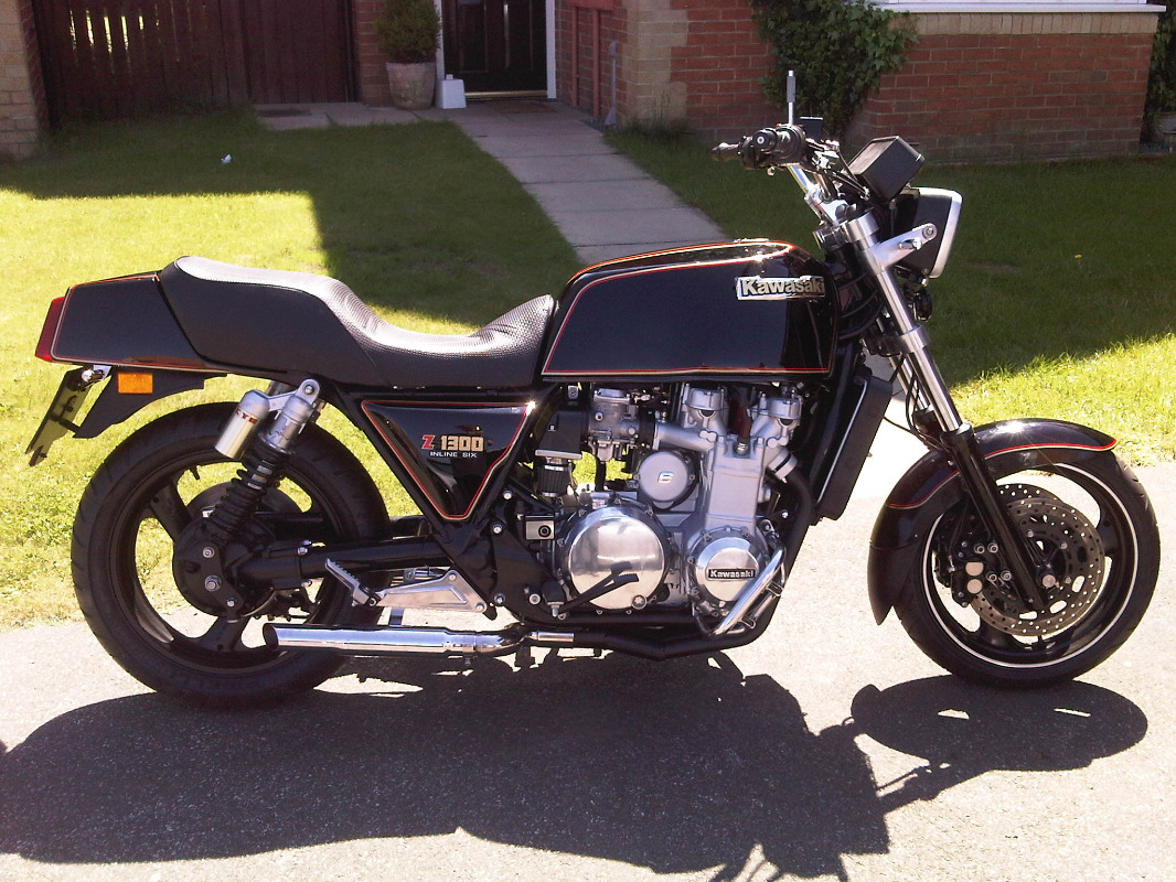

Speedo Pick Up looks good there mate, neat and tidy...............well done !
I can remember both me and Phil building "special Z1300" bikes around the same time...........probably 11 - 12 years ago and we both arrived at the same conclusion back then with the Acewell Speedo and rear wheel pick ups.
Your bike looks impressive and alternative, which I love and the way all special builds should be.
You should think about contacting a Custom Bike Mag when you are finished, as many of them are on the hunt for project bikes like yours as a feature bike.

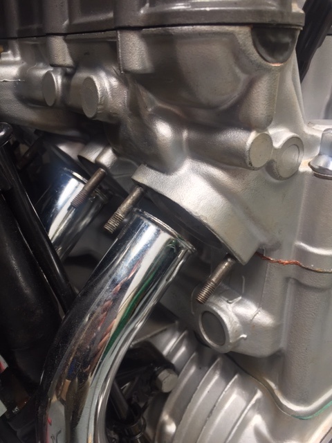

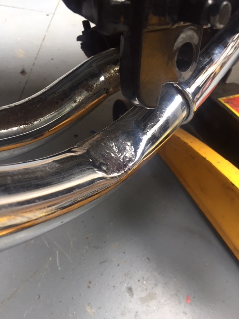

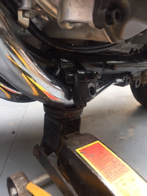

In the meantime I test fitted the exhaust and ... surprise surprise! .... another issue popped up:
... and how I solved it!
Yes, I bashed the pipe in to get round the side stand bracket which I obviously welded a little too far forward - but how was I to know? Of course I know now for the next time, and for this bike I will get a completely new system anyway.
The old system I have is fairly damaged, needs a lot of welding to plug all the holes and will only be on the bike until I can get my custom system fitted and then will go on Ebay for a fiver or so...

Oh yes...............
The good old exhaust fitting process on a Z1300............I have learned many new and offensive swear words doing that over the past 40 years !!!
I too have resorted to the JACK idea with good and bad results, especially if you intend to fit the centre stand.
As for the Air Filter mod..............I took the top section of the standard Z1300 air box and mated a flat aluminium plate to the bottom of it and fixed 3 x 50mm round sleeves to the base of the plate to fit common 50mm round pod filters onto so I could then fit common and reasonably priced 50mm ROUND filter pods onto.
This worked really well and looked good too !
Hope that helps ?
