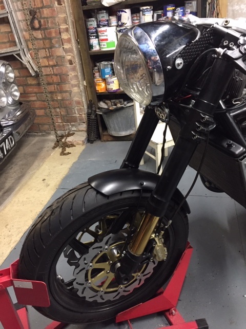

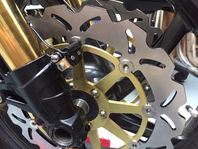

Ok, found a good place for the sensor, right in front of the holes in the front disc where the magnets can go, attached with some Sugru. There are nine holes, so I can either get three or nine magnets if they need to be at consistent intervals. So nine it is ... (I have not seen a restriction of number of magnets in the speedo manual, but I guess I will find out if it works when fitting them)!
Another issue... the sensor wire. I have for now wrapped it around the brake cable, but that looks awful. Not sure what to do with it, but I'm sure I'll come up with something.
I have still not found anyone to do me a bespoke exhaust, but I have found the one exhaust pipe I was missing from my old system, so I will weld that up and hang it under the bike, so at least I can start her up - albeit a little noisy!
Oh, I painted the front spat black - much better!
