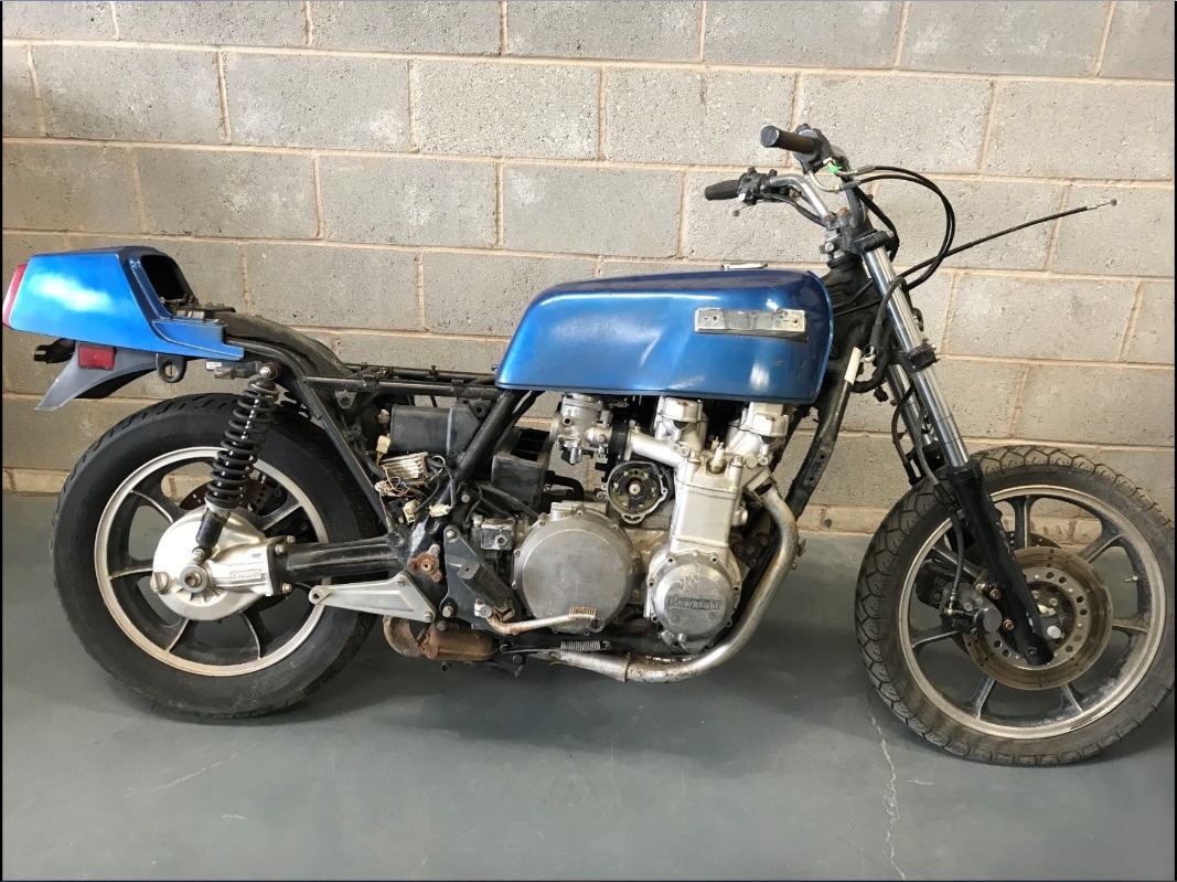

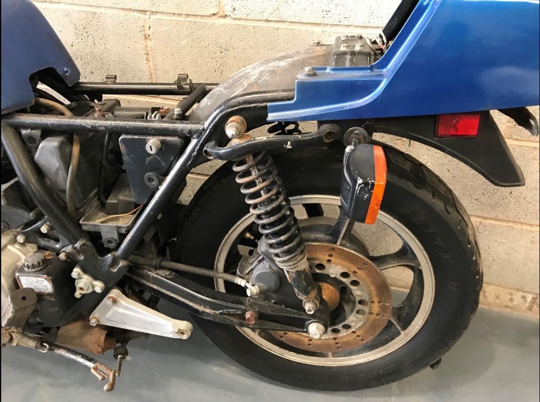

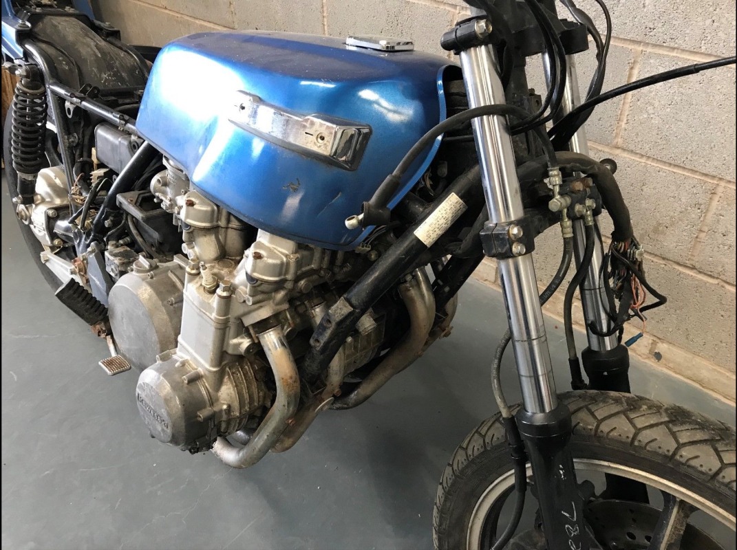

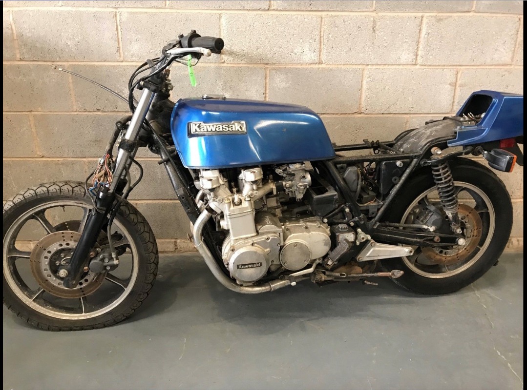

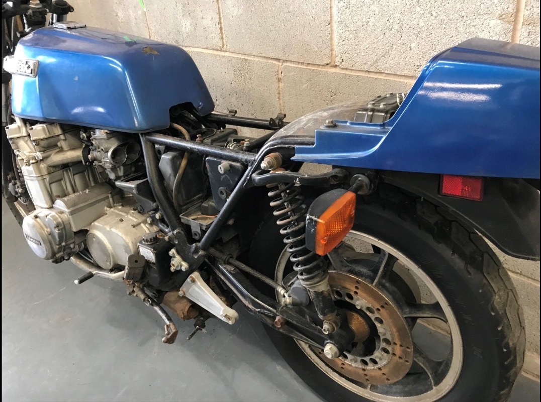

Another odd one... (they seem to find me!:S ) ... I sold off the old front shocks and wheel and discs that were on the bike when I bought it, but the guy who bought them says they cant be off a z1300 as the shocks dia is 2mm thinner, the discs are slightly smaller and the wheel is 19". Even the speedo drive doesn't fit he says.
If he can't use them I will refund his money, but I am at a loss to explain it. This is not something 'special' they did on some KZ1300's? And then, if true, why and what can they be off of? Length was 83cm and there are not many bikes with that long forks... and they are definitely Kawasaki... and the steering pin fits my bike perfectly...
Attached some pics of the bike as bought.... perhaps anyone has any ideas?

The photos look like a 1979 A1. The early ones had 10 1/4" (260mm) front brake rotors. Later production (all KZ1300's) had 12" front brake rotors.
Front fork assemblies for 1979 A1 & 1980 A2 are the same. Inner fork tubes are the same for A1, A2, & B2. B2 has different outer fork tubes.
A3 & A4 have a different front fork assembly. The outer fork tubes are the same as a B2, but the inner front fork tubes are different. Sorry, I don't remember the diameters.
No clue as to the 19" front wheel. The speedometer gear box assembly is probably unique to the 19" front wheel.
After closer examination of the photos, my opinion is that the entire front fork front/wheel assembly is from some model that is NOT a KZ1300.

Definitely not a Z1300 or KZ1300 front end and front wheel.
Probably Z1000 or similar Kawasaki from that era. I "Think" the Z1000 LTD had slightly longer forks and a 19 inch wheel.
Definitely a KZ1300 frame.
The White oblong sticker on the front right frame down tube will confirm exactly what the bike was built as (USA Federal Sticker) which shows date of manufacture, weight, frame number, tyre sizes etc, etc......

Best guess: Kawasaki Z 1000. Maybe 1980 -1981. Had 19" front wheel and 9.25" dual front brake rotors.

Thanks guys... still remains the question: why? But he, mystery (sort-of) solved.
I'll let the buyer know what he may have bought - well, .... has been given, as I refunded him.
