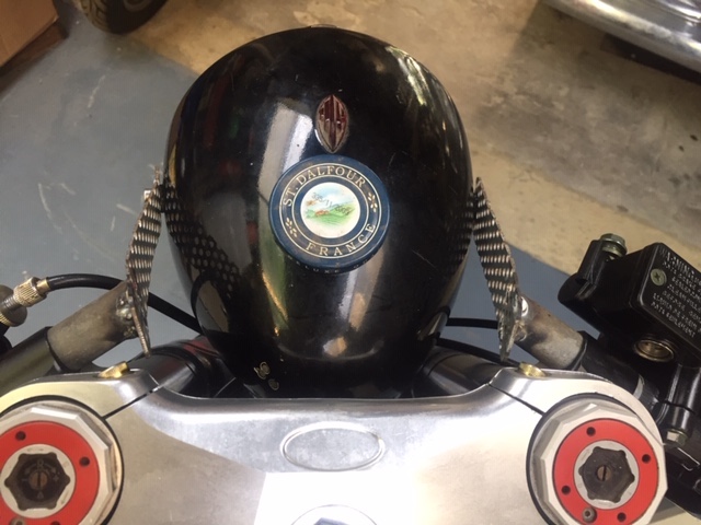

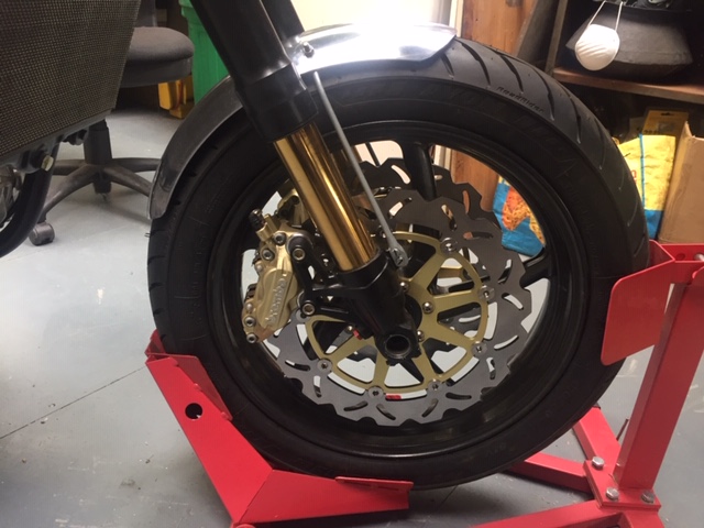

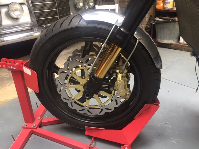

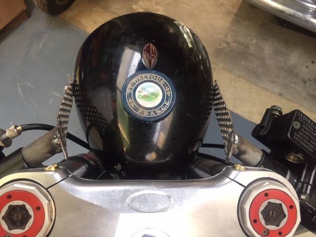

Fitted test handlebars (galvanised water pipes) to see how the brake MC, clutch and handles fit (they fit fine) and then put in the (Citroen Traction) headlight and tested where the new speedo could go with a jam jar lid of equal size.
i love the front fender!!
did you make it or Its aftermarket you can buy?
Then I fitted the front spat. Two bars was too unstable so I was going to do four stabiliser bars, but I broke two bits trying to get the RH Brake calliper bolt off before I gave up. It is stable enough and will all be painted black, so methinks no one will notice.
I have taken the bars off to paint and hopefully tomorrow they will go back on, permanently (yeah right, not likely!).
Last thing I did is spend fifteen minutes on the phone with a brake line manufacturer to have two front brake lines made... cant wait!
I love the front fender Paul
did you make it or after market you can buy?

Type this into Ebay UK:
Short Front 120/70/17 Aluminium Mudguard Fender Cafe Racer Brat style Bobber.
The bars are made from stabilisers from an Ikea cabinet.... they come with metal bars that cross over each other at the back to give strength.
