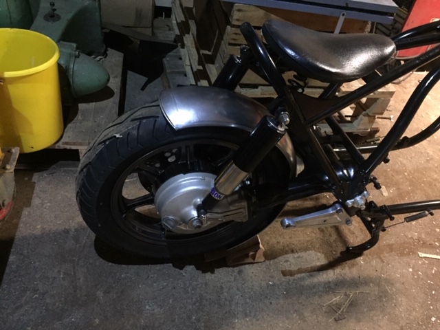

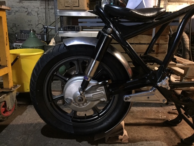

Got a rear fender. Still full size, have a play to see what looks good. But can't affix yet as the stance of the bike will change with the engine in. But have decided how to fix this to the unsprung part of the bike : four stiff steel brackets onto the end of the swing arm.
On that front: still need to find someone to turn me a sleeve for the steering pin and bottom yoke.

Re: the last picture - laughing at myself ! For a split second I thought you'd made a front wheel drive version. Duh ! :whistle:
6 years 7 months ago
Ha! Good idea for the next build!
Steering may be an issue.... rear wheel?
... gonna get complicated!
