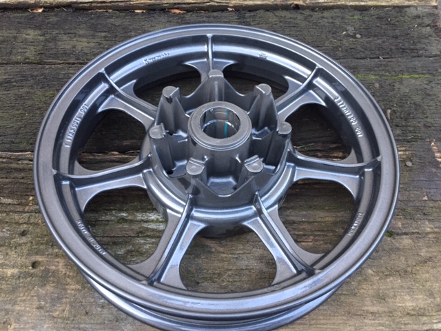

In the meantime, the powder coater has managed to powder coat the rear wheel in the same shade as the new front wheel - anthracite grey. Looks great! Ready for new wheel bearings and brake disc.

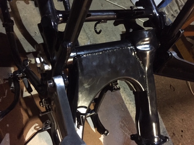

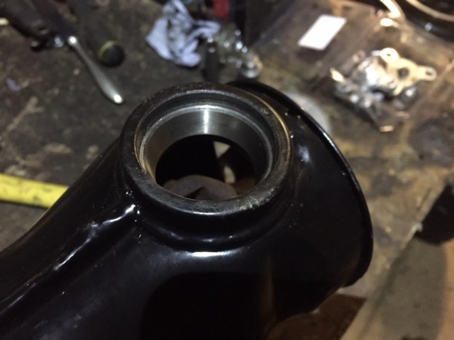

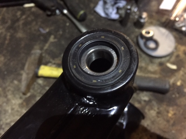

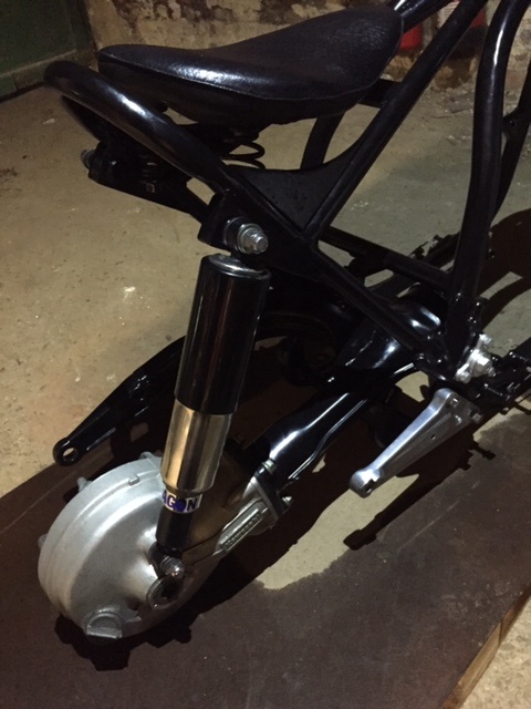

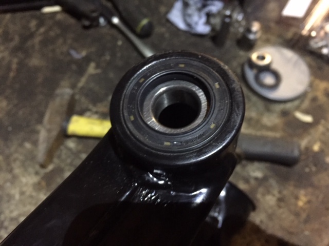

Update; cleaned the swing arm pins, inserted bearings and re-installed the swing arm (see other thread). Also re-attached the final drive and one shock to keep the whole thing together.
Now awaiting top yoke and tyres to build up the front end, and then I can slot the engine back in to the frame.

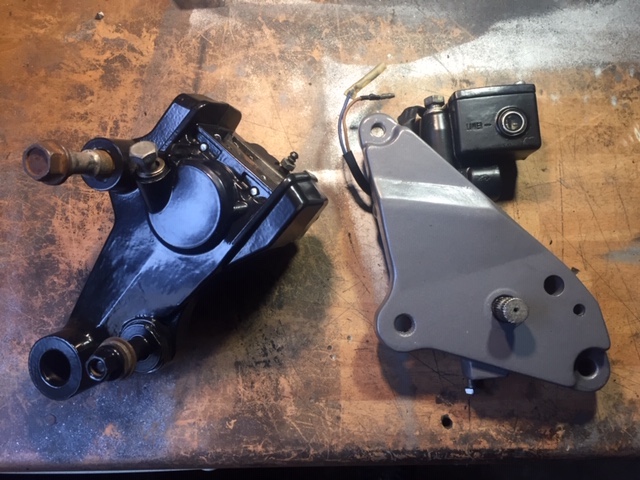

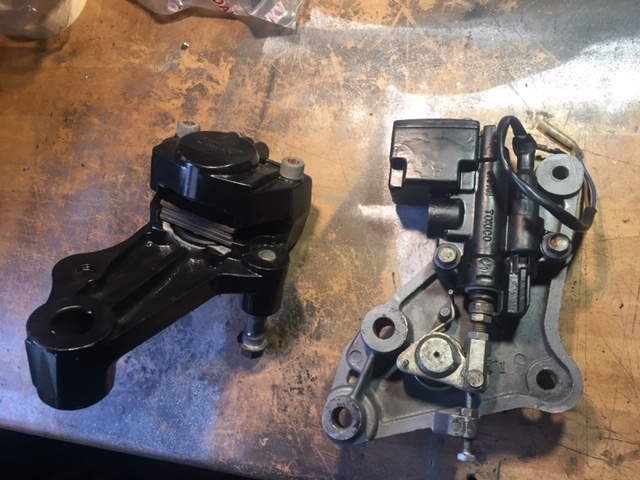

Rear Brake caliper, shot blasted, powder coated with new piston rubbers, ready for installation, alongside the refurbished MC plus mounting plate.
