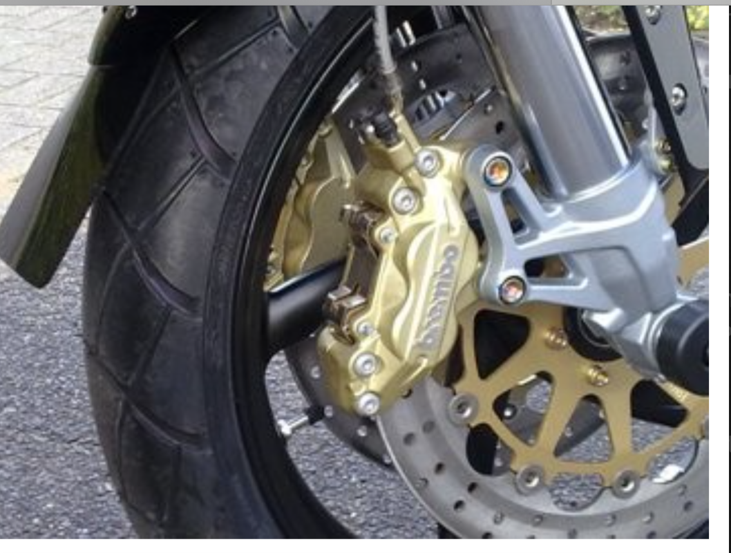

Grr... forks are the wrong way around! Gotta take it all apart again - that is the fourth time!
This is how they should be, and on mine the 'sunken' bolt head holes are on the inside. :S
