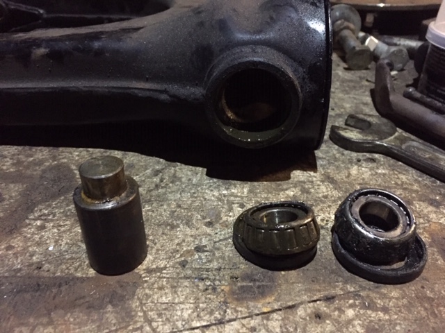

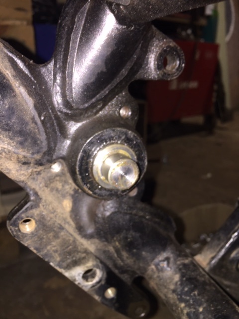

Right, swing arm is off. That took only 20 minutes!
I think I got lucky as there was no rust, which is pretty good for a bike that has stood for so long that the engine had rusted solid!
I made an even simpler tool that elsewhere on the forum and simply pushed one pin out. It helped that the engine and driveshaft were removed!
Then the swing arm fell out on its bearings (which ARE shot) and then I simply tapped out the other pin.
Easy-peasy (compared to some others on the forum)!
Off to sandblasting and powder coating the frame!
The LH side one after the swing arm fell out:

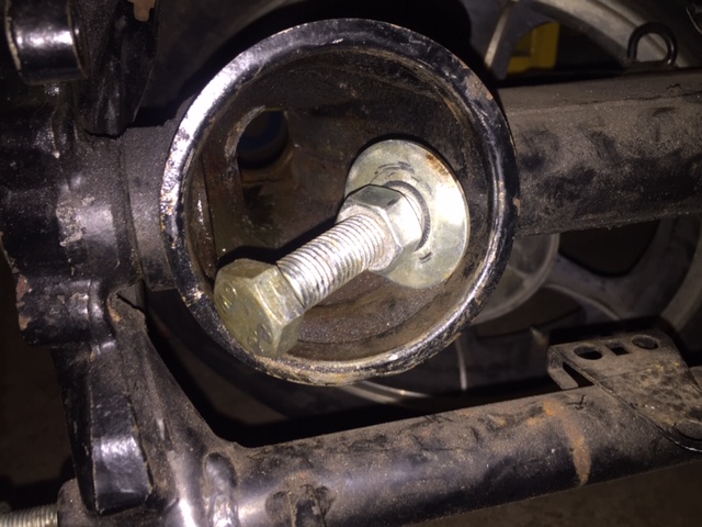

The tool:
The RH side one plus two bearings:
The tool:

I feel dumb here... How was 'the tool' used? I just see it sitting in the cavity of the swing arm, but what did it do?
6 years 10 months ago
The head of the bolt goes against the pivot. Then you turn the nut against the washer, pushing the bolt head out against the pivot, pushing it out.
At a stage I needed to insert a loose, smaller dia nut between the pivot and the bolt head as the bolt head dia was too big and pushing against the bearing/frame.
