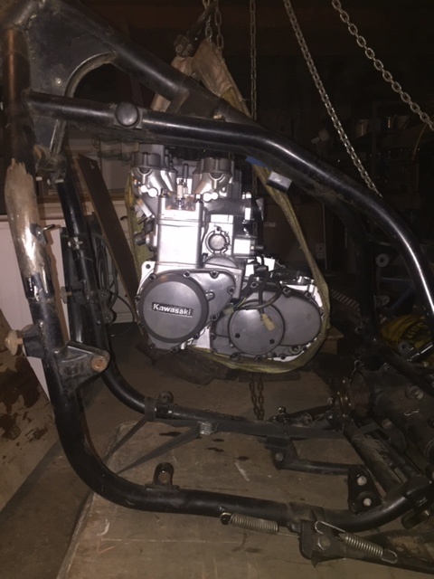

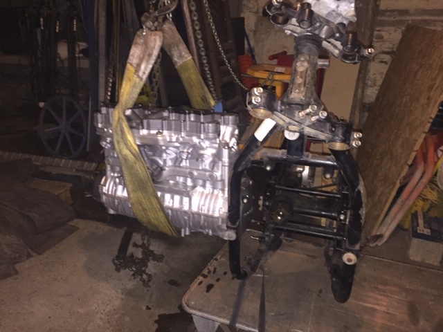

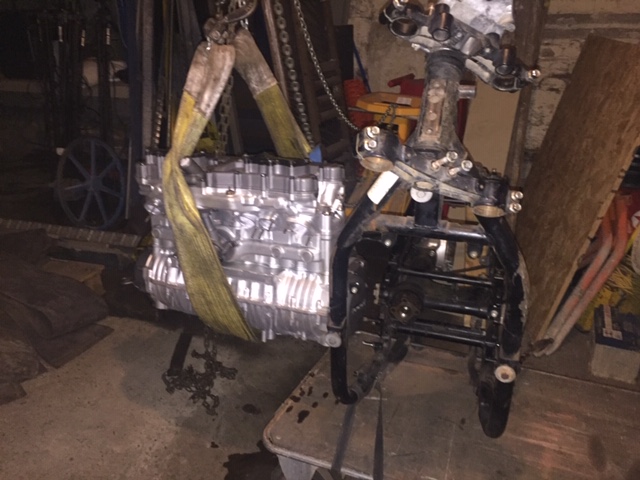

Right, that was a bit of a job, but it's in! I hoisted the engine up and strapped the frame to a dolly on wheels so I could slide the frame around the suspended engine.

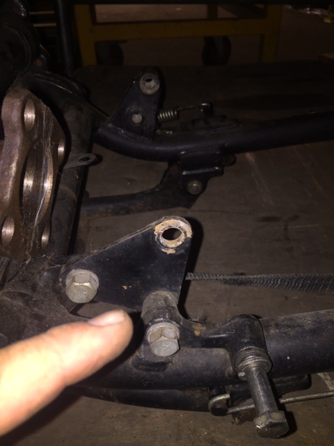

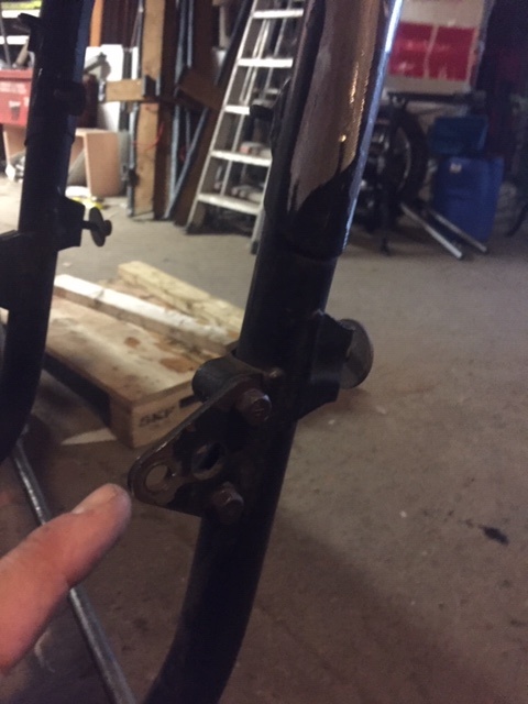

Initially it just wouldn't stop fouling the frame, until I figured out I had forgotten to take two engine brackets off (doh).
Then I lined the whole thing up again

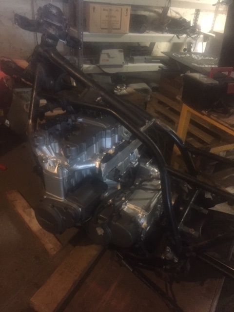

and with quite a bit of manual pulling and shoving it did eventually drop into the frame.

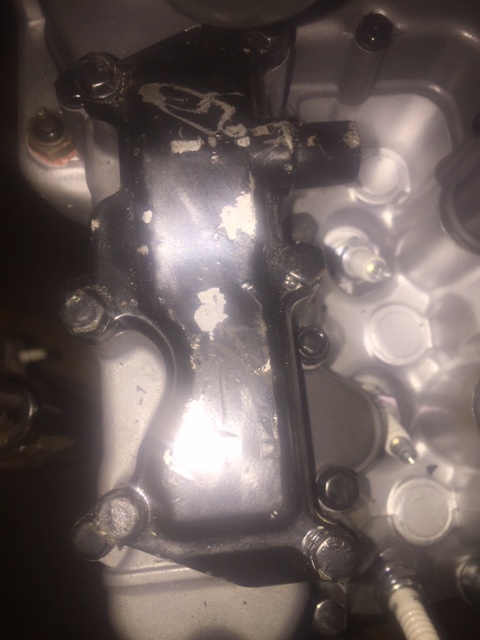

Only thing that suffered was the LH breather cover, but that can easily be taken off and repainted..
Now I'll attach the carbs and see whether I can cut the frame where I want to.

Great! It's a big step! I am wondering - will you be removing the engine again for frame fabrication or do it with it in? In this case I suppose the frame will also be painted with the engine installed.

It depends... if there is enough room to cut and weld with the engine in, it will stay in. If not, then it will have to come out again for the frame amendments, and then go back in to build the bike up. Need to have the engine in to determine stance, fork length, ride height, exhaust routing etc etc.
I will build it up to a 'running/rideable' state to make sure everything fits and all brackets on the frame are in the right place and/or removed. Only when I'm happy with the end result will everything come apart again and get painted, and finally re-assembled.
... loooong term project remember?
