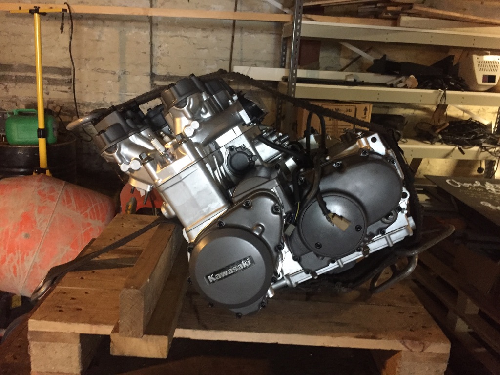

Here is the engine on a workbench ready to be winched up.

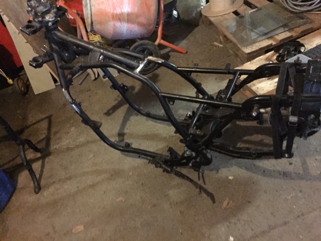

Here is the bike awaiting the engine

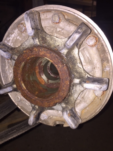

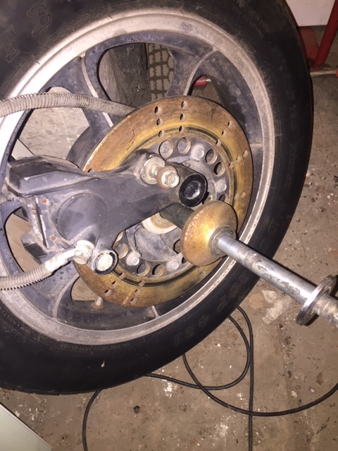

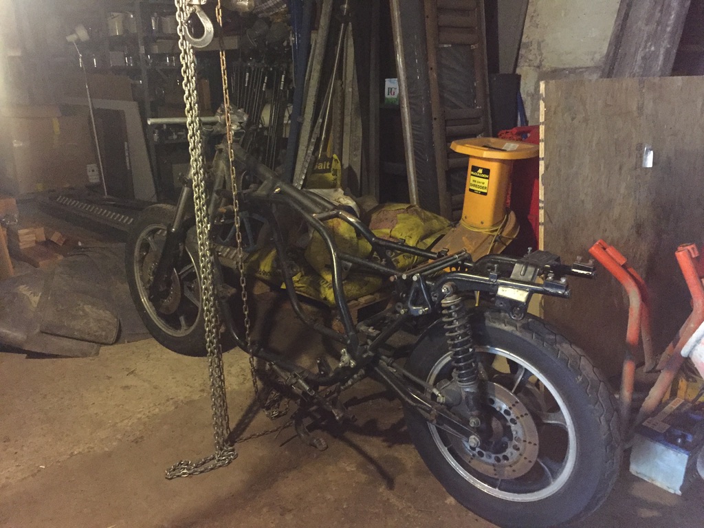

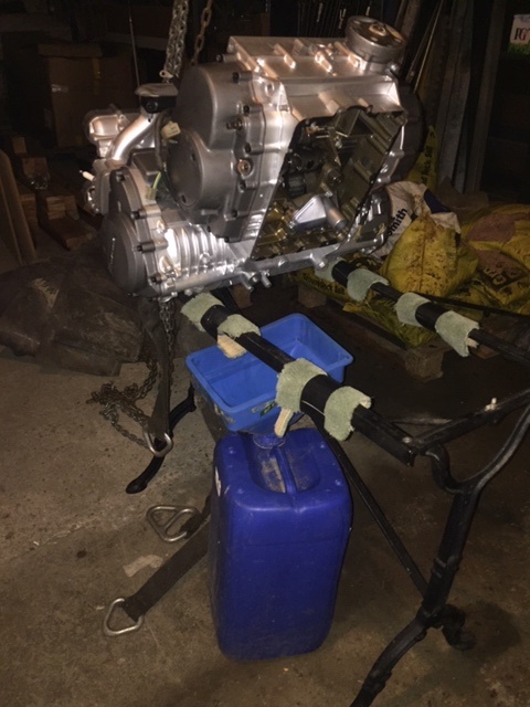

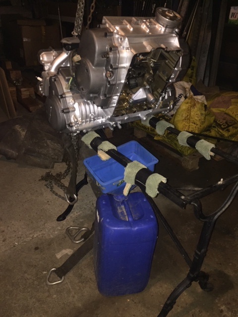

Ok, got the wheels off. I decided against removing the swing arm as it felt fine and I know from this forum it is a b*tch to remove. So Ibanded it up and now the chassis can be handled by two people whilst a third manipulates the engine in - which has the oil pan now removed.
Chassis without wheels
Bit of rust in rear wheel hub
Rear wheel with brake calliper stuck on the disc (more rust)
Engine with sump removed
Plan is to try insert the engine into the frame by manipulating the frame over the engine lying on its side.. we'll see how we go.

Manual shows it going in from the side with engine hung from a shop crane. That’s how I did it with one helper. No issues.
- Posts: 3298
7 years 3 months agoFrank833 wrote: Manual shows it going in from the side with engine hung from a shop crane. That’s how I did it with one helper. No issues.
Same here. Followed the manual and using a chain hoist, removed/reinstalled the engine. It's tight and little wiggle room but it came out and went back in with the oil pan on.
