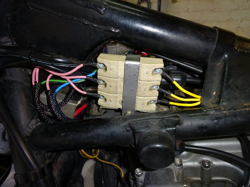

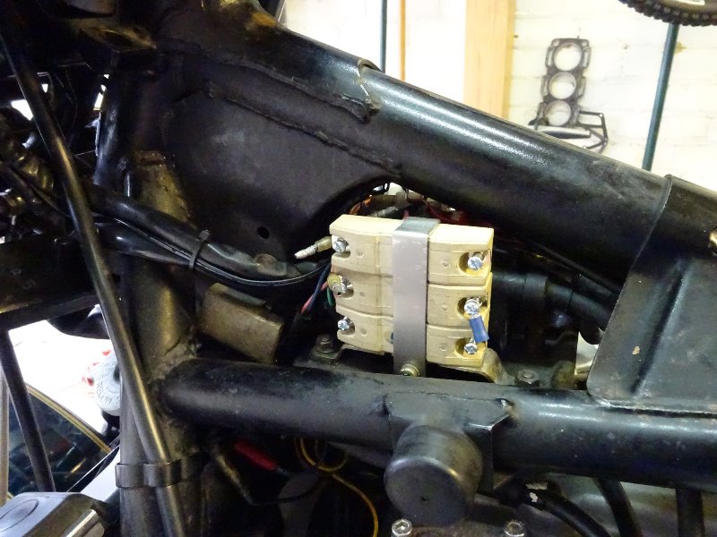

To gain enough clearance between the new ballast resistors and the tank, I made two modifications. The first was to move the resistors slightly further forward than the originals so the front of the resistors slightly overhung the front of the bracket. I made a strap out of stainless steel that was less wide than the recess in the ballast resistors to enable this. The second modification was to the original bracket and its two "feet". The picture below shows the resistors mounted on the standard bracket - when I used my "plastigauge" approach to check clearance with the tank, it looked very tight, maybe only a few millimetres, so I modified the bracket to slope downwards from front to back. You will see in the second picture that I bent the front foot of the bracket to be close to vertical whilst flattening the rear foot to maintain the distance to the mounting holes. This gave me over 5mm of clearance to the tank which thought would be acceptable. Hope this is helpful!

Thank you. That's what I was thinking looking previously at your photos (bending the bracket). I am going to do the 'plastigauge' test as well. I remember a discussion about different shapes of fuel tanks, I think it's a good idea to see what exactly is going on with mine.
Didn't you think about covering those terminals with something, just in case? The tank sitting on rubber, I actually wonder if it's all on it's own or grounded somewhere to the frame.
The tank may sit on "Rubbers" but it is grounded by the Fuel-Gauge ground-wire.

Yes, I did think about insulating the terminals but I could not think of a good way to do it. It would need to be very heat resistant as well as an insulator. I also needed to avoid anything too bulky as there is not much room particularly around the back end of the resistors. I was also aware that they are not insulated when used for their primary automotive application. The terminals are recessed into the ceramic block so unlikely to contact the tank or frame.
