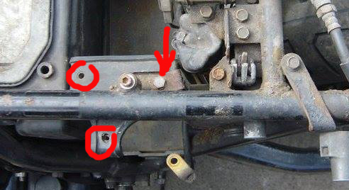

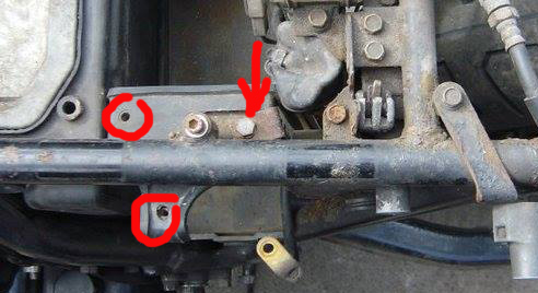

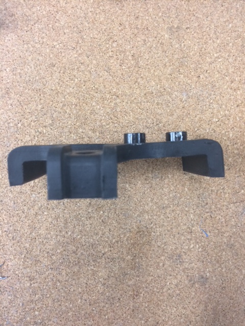

#20069
Could anyone tell me what are these two holes on the left for? They seem to have no purpose..
And that bolt where I pointed the arrow - what is it holding? A bracket for something?
Last edit: 8 years 5 months ago by StanG.
  • scotch's Avatar
  • Posts: 2063
  • Thanks: 953

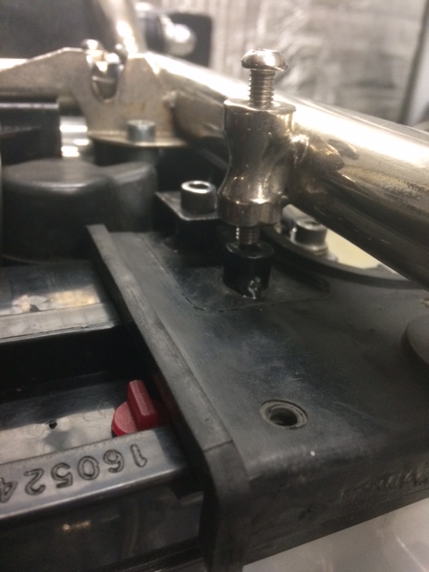

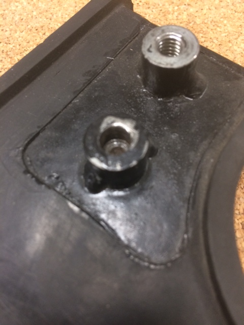

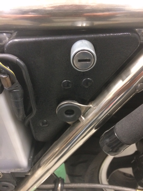

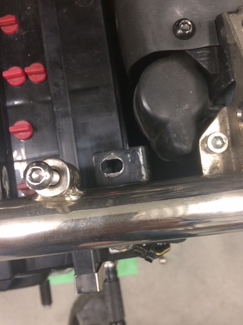

#20075
These should help, Stan. The two holes(?) don't do anything. They're probably there for production purposes to allow the rubber "coating" to be injected evenly to both sides of the hold-down bracket.(?) The Short screw is a hold-down for the top portion of triangular face plate of the Primary switch. The long screw threads into the frame-boss and "floats" in the hold down plate. Hope the rest is self explanatory.
Last edit: 8 years 5 months ago by scotch.
