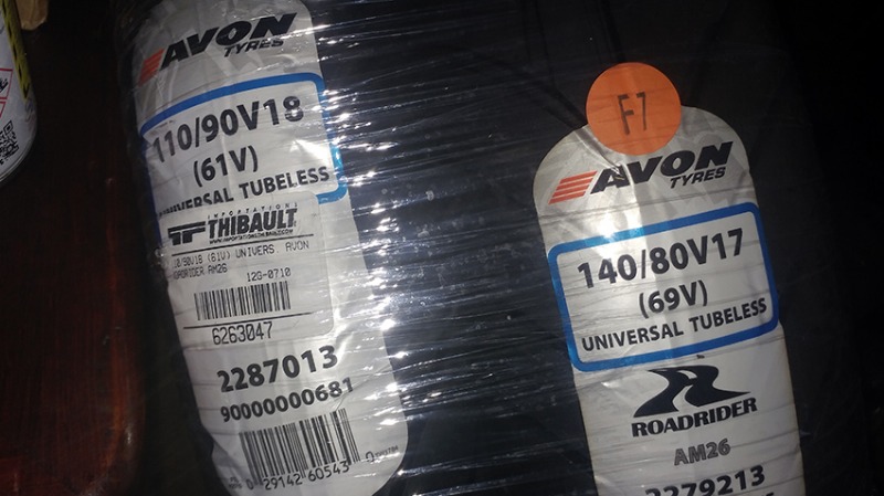

8 years 6 months ago
It'll be nice to see those mounted, Stan. Are you going to fully assemble the bike before returning it to ground level? I just wondered how you are going to get it in the lift at your apartment.
