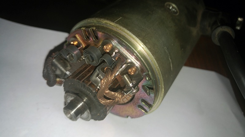

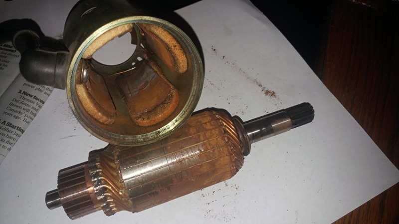

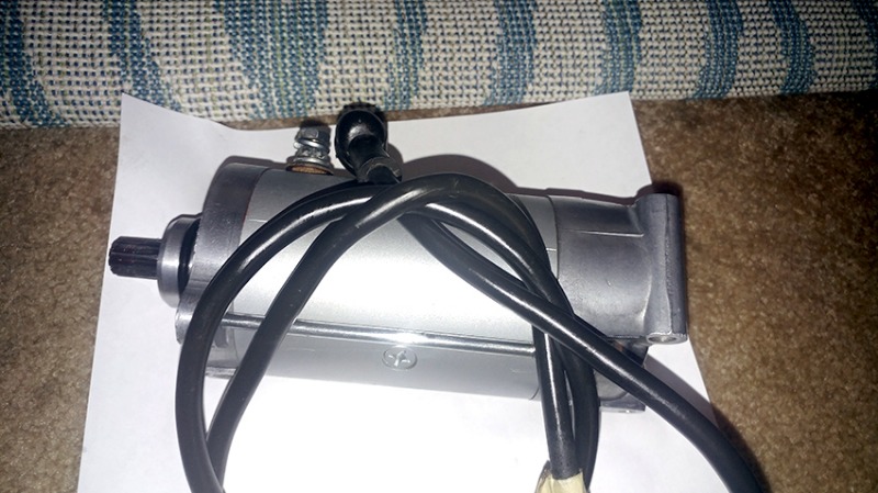

Yesterday I took care of the starter. It looked fine on the outside when mounted on the engine. Not so hot when removed... It was seized. I got it turn after gently back and forth, but of course it had to be taken apart.
Here is the culprit - rust.
The other side.

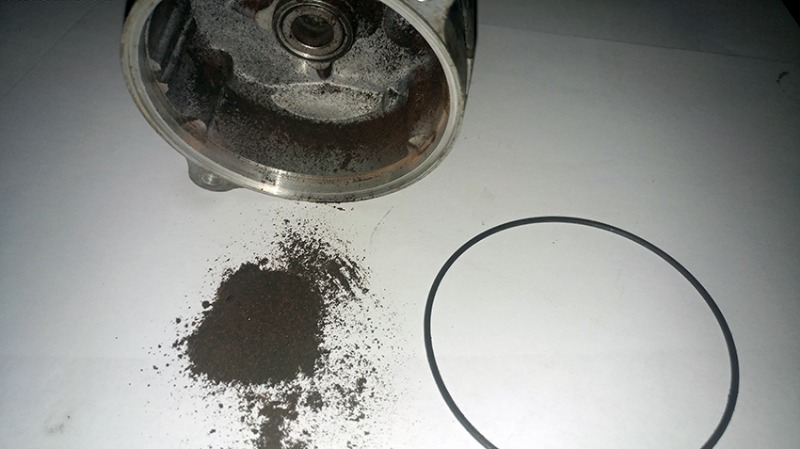

Lots of carbon from the brushes. They are a bit short but still usable.
All cleaned, ready for reassemble.
The other side.
9 years 2 days ago - 9 years 2 days ago

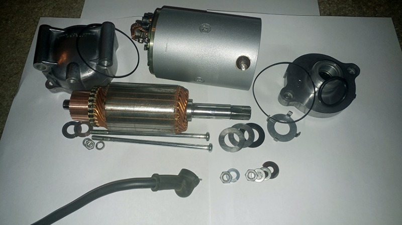

All back in one piece.
I completely removed the rust very carefully with wire brush and sand paper. Then some polishing with Autosol metal polish followed by spraying all with electrical contact cleaner. All shiny inside-out. On bare metal I applied ACF-50 aircraft anti-corrosion formula.
The casing was sanded and sprayed with 65% zinc rich galvanizing coating. Very sturdy. Both ends of casing polished aluminum and rubbed with ACF-50 for protection.
Inside bearings cleaned and greased.
Turns beautifully, ready to go!
It's easy to disassemble and service the starter. I replaced the end seal but left the two casing big thin o-rings on. If I find new brushes replacements in the future I will exchange them. The current will work well for in the meantime.
