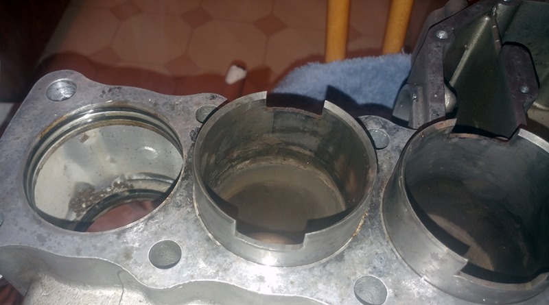

One ring top, two rings bottom sit in the block.
I put the block in the kitchen oven, then tapped the sleeve using block of wood and a hammer. One thing I would strongly suggest is minimize much more the drop and put some soft towel below the sleeve. This was the first time for me and I didn't know how much space I'd need. No need for this much. Just enough to have the sleeve drop gently.

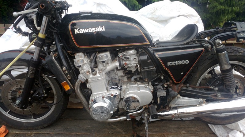

9 years 2 months ago
My God, was that thing used as a boat anchor....
I have had scrap parts bikes in better shape. Anything is fixable with enough time, effort, and money.
You have what I would call a " difficult" resotration. Not for the faint of heart. Good luck and Godspeed.
Making that thing run again will be an inspriration to even the most seasoned of mechanics. Lots of spare parts floating around this site as well. Put up a wanted post if you haven't already.

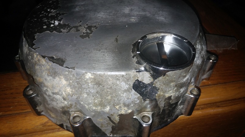

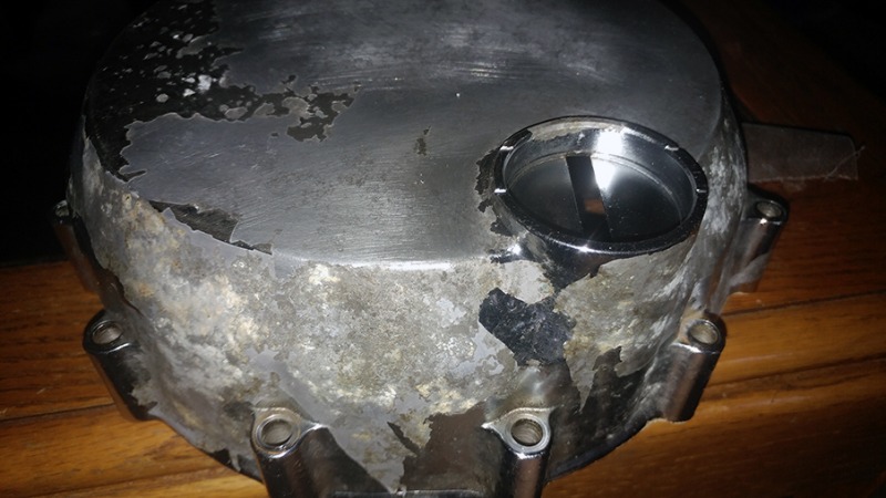

Clutch cover. Lots of hours cleaning it up. This is mid work. Later on I spent another 5 hours cleaning and polishing it before taking it to the shop for new chrome. The prices around Vancouver are outrageous!... One shop told me 400 bucks, another 120. Both removing chrome, nickel etc. and then back. Nuts... In any case, spending 10 hours on as much preparation as possible - I don't mind. Should have results by the end of the week. This one cover is definitely in my view I can't go without chrome plating. It's like a centerpiece.
