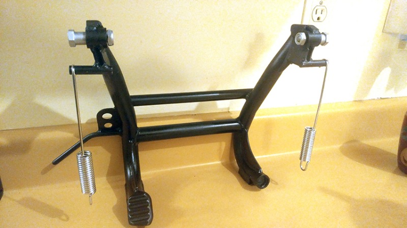

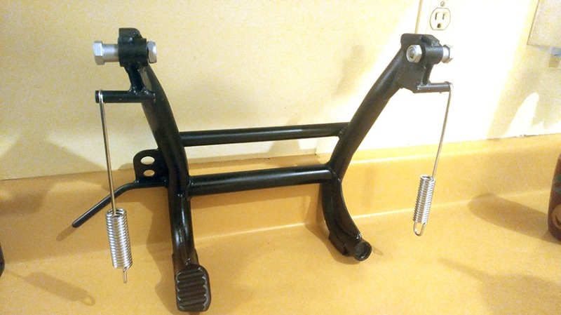

I've had the center stand painted and sitting for a while. Now the chrome plated springs joined it and it's a complete set. I used PlastiKote chasis and grille guard paint. It seems very tough. I think it's good for touching up the frame.

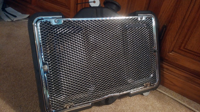

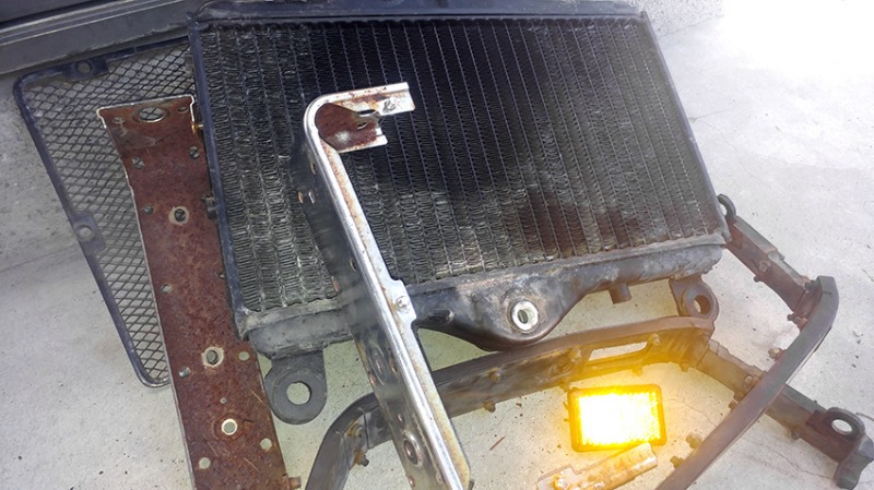

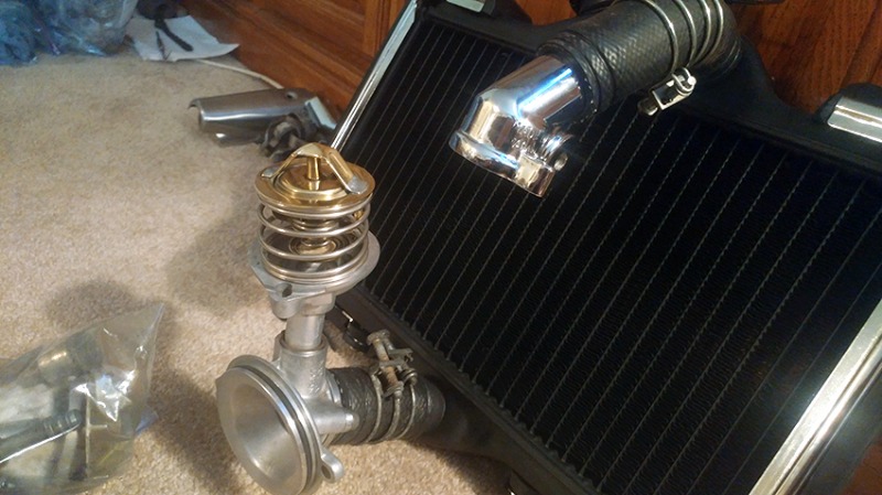

The radiator part is also almost finished. This is what I started with:

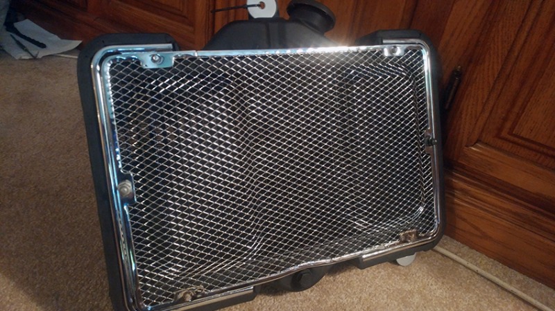

I masked the radiator blades and soda blasted the sides. I also glass bead blasted the other heavily rusted parts and oxidized aluminum housings.
The guards, screen and mounting screws, and the fan switch housing were chrome plated.
I already have the gaskets and some of the o-rings.

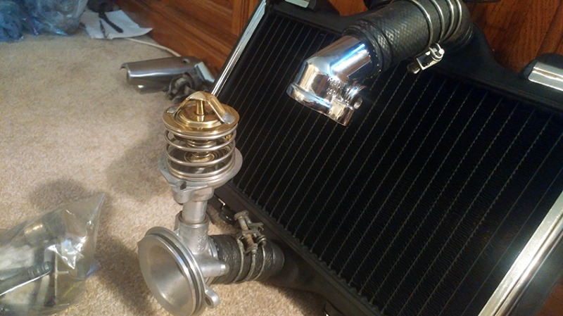

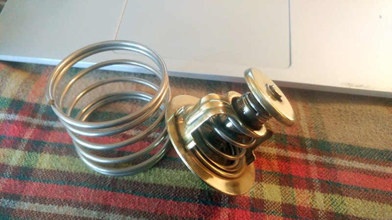

Everything has been checked and polished, including this thermostat
The upper hose is fine and soft. I am going to get the lower part from automotive store, and replace the clamps as well.

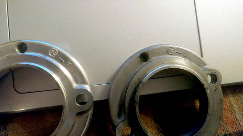

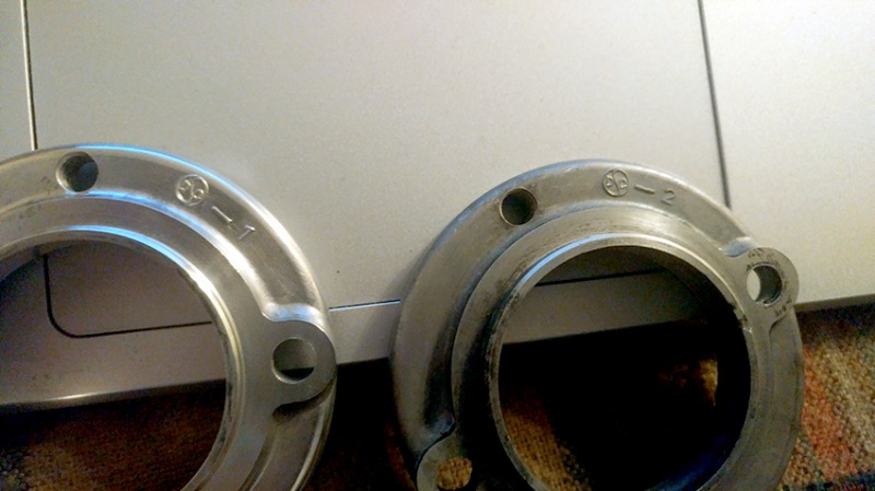

In participation of putting the engine together, I organized all the parts of the water pump shaft, new seals etc.
I had to order another used engine block because all but one of the cylinder sleeves were pitted beyond being salvageable. The block came with a water pump shaft, unfortunately the plastic sprocket was damaged. The oil seals and the mechanical seal had to be replaced, and now I was just comparing the two. Both housings are identical, but one is marked with '1' and the other with '2'. Both bikes are supposed to be the same year. I wonder if anyone knows the story behind this. Maybe it points to location where they were made?

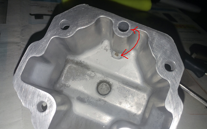

I already ran into having a question. These two passages in the bowls seem to be connected when I blow air in it. But very barely. One doesn't let any air through. What are they? I assume they should have no restrictions.

I was just reading Scotch's carburetor thread. I think the passage must be free. It's for the pick up tube for fuel delivery to the choke plunger. Please correct me if I'm wrong.
