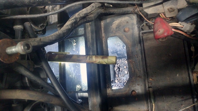

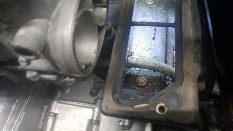

I removed the battery and the top air filter compartment. This exposed the bottom air box.
What a surprise there! It's not clearly visible, but I found down there pieces of a variety of seeds, nuts, and some leaves. My guess is there was a rodent living there. I don't think mice or rats, because there were no droppings. I would put my bet on a squirrel family. All dry and nobody left behind, I hope they grew up safe and had, or have, good happy lives.
It took me a long time to remove all the bits of the organic pieces.

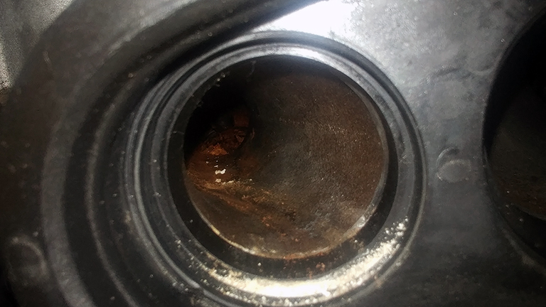

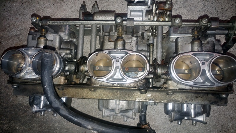

I removed the attached vacuum hoses and the fuel valve, and pulled the carburetor out.
As you can see, there is some rust that sipped through to the carb #4. Everything is completely stuck. Nothing moves. But that's for later.

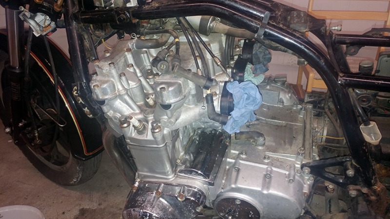

I am just checking where I left off and here I go with a few more photos.
As I go along a few will duplicate if the story needs a clarification and a reference point.

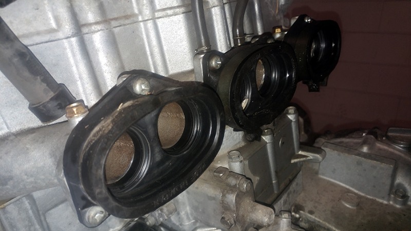

This is the view after removing the carburetor.
I have followed the intake passage of the bad looking carburetor, and found out that in fact water seeped through the intake valve guide.
Next few photos leading to removing the head.

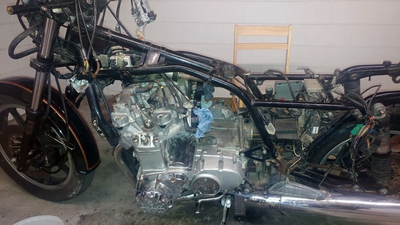

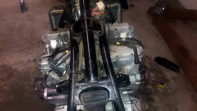

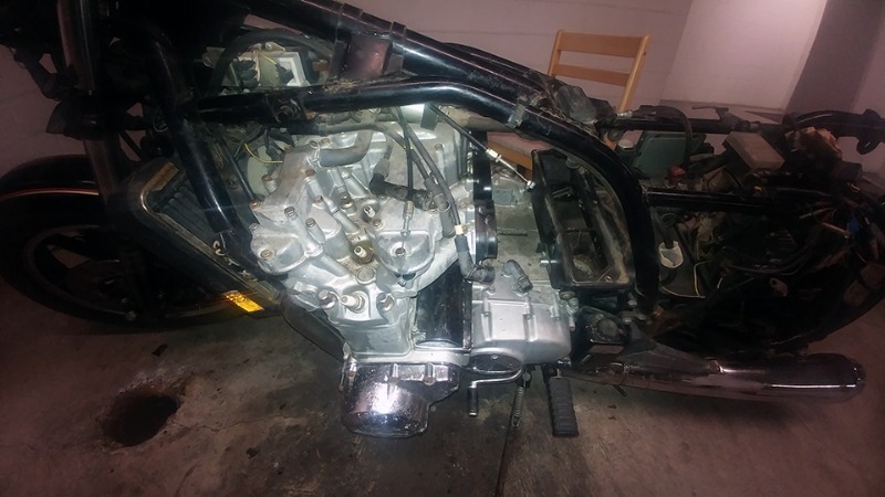

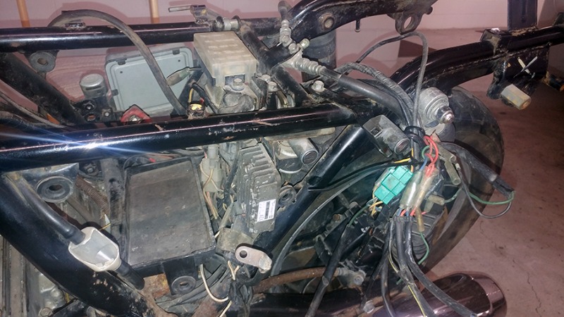

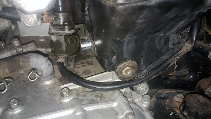

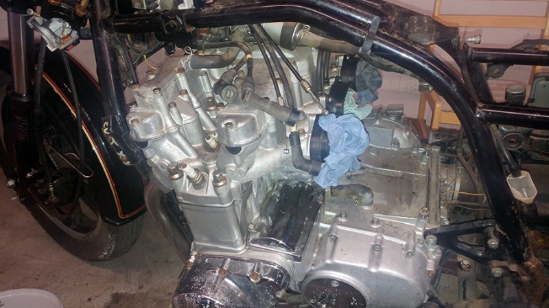

The bike is being stripped in my friends underground garage, and bit by bit moved to my apartment.
Few more photos of the strip down...
