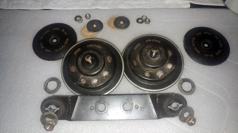

I'm posting these photos of assembly layout to have a reference and for whoever never took these apart would see what's going on. Much better than the black and white parts diagram.
Se here another gem. Just took apart the horns. I'm going to sand the painted pieces and paint. Some areas will expose bare metal, so I will first use etching primer.
The metal rings around the horns were corroded, I will just throw a layer of zinc rich paint on them. It will give a good protection and a nice silver look as well.
