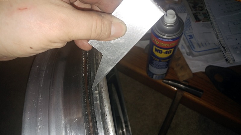

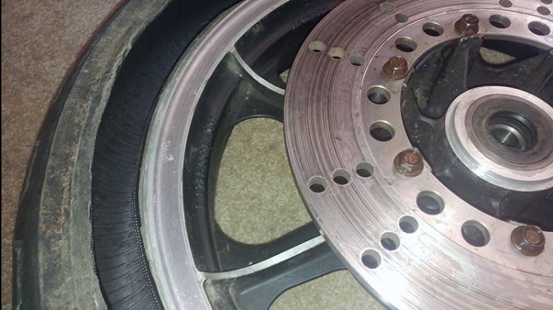

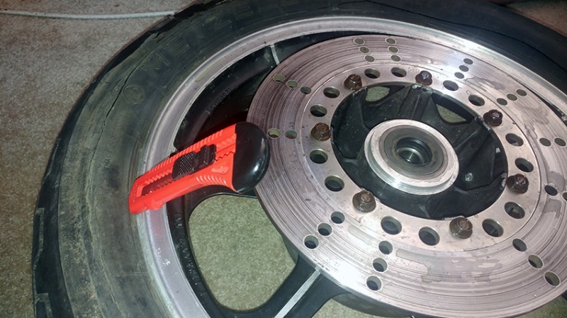

The sides of the tire are thinner and not as much reinforced as the rest, so I cut along the rim, close to it. Both sides, easy in 5 minutes.

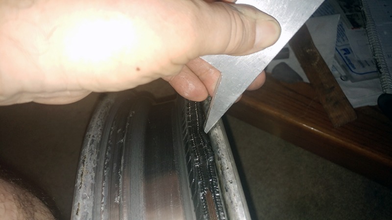

Next a piece of scrap aluminum I happened to have by chance. I always keep weird things around feeling that thy are here for a reason. Sometimes the answer comes soon, sometimes it takes time. But everything finds it's place and purpose eventually.
I applied some WD40 and gradually hammered the aluminum wedge around the wheel moving the leftover 'rings' of the tire towards the center.

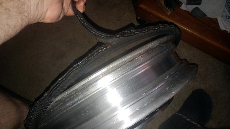

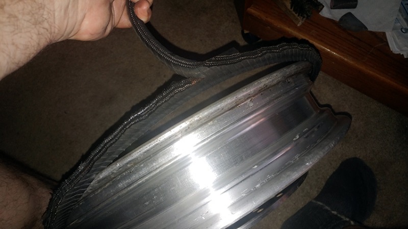

I left one longer piece of the tire to have something to hold while pulling the tire off the wheel. With WD40, it didn't take much power and it just slid right off.
As a bonus, it also cleaned the wheel very nicely afterwards, when wiping it with a rag. Without watching the time, I think it took probably 20 minutes..
