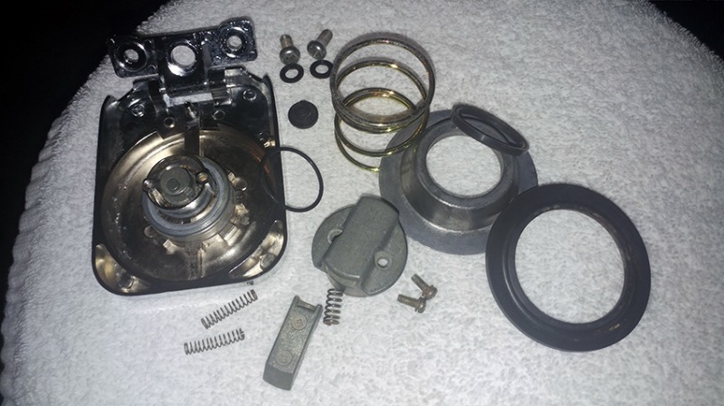

In the meantime, I took apart and cleaned the fuel cap. It was all plugged with rusty dry mud. Now all clean ready to assemble. Here a picture of what it looks like dismantled.

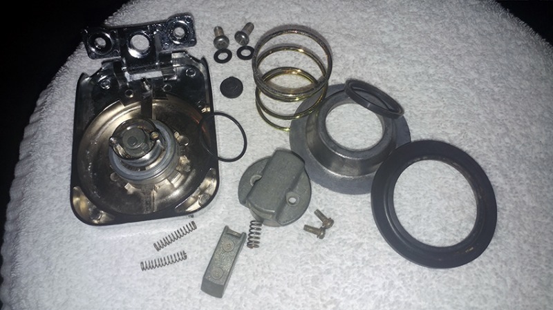

The breather seal is damaged, I have to find a replacement. (this should be one piece) If I can't, it should be not difficult to improvise and make it work using something else.

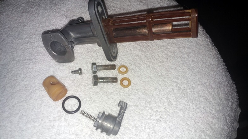

Another mini project. The petcock taken apart. I got it from eBay, and it fits!
The distance between the centers of the mounting bolts it 44 mm.
All is good and I will test it after putting it together. But most important is to find and replace the filtering mesh. The plastic doesn't want to come off, I think it's glued to the metal.
So the two options are to find a mesh and attach it using epoxy without removing the plastic cage, or remove it and make a good size mesh from brass and solder it in place.
Not sure yet which way will I go. Still using my imagination and not finished with it yet

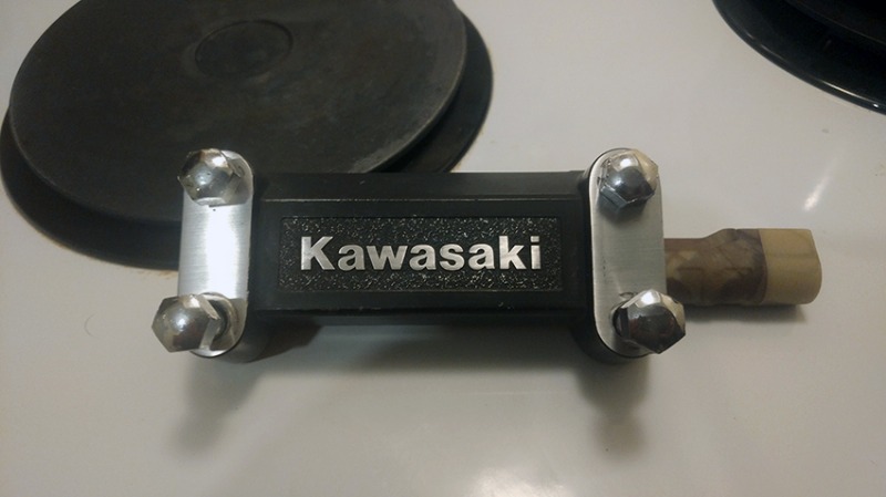

8 years 9 months ago
It was ALL black, so I had to improve it a bit. Silver lettering and brushed aluminum on the sides, plus a bit softer background. Acceptable? I like it
8 years 9 months agoStanG wrote: ... But most important is to find and replace the filtering mesh. The plastic doesn't want to come off, I think it's glued to the metal.
Keep me posted about that Stan - the screen on my 86 tap is missing and I'm looking for a replacement.
Hi Stan,
Could you tell me where the two larger springs go. It’s been such a long time since I dismantled the cap I can’t remember where they go.
