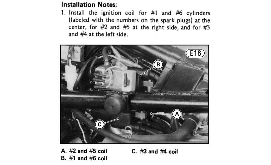

After a short break back to Kawa mysteries. This time we disassembled all six injectors and tested the whole pressure rail with injectors intact for any leaks. There was none.
Flipped spark plug wires from coils, did not make any difference.
They are now connected this way:
1+6 wires go to right side coil
2+5 wires go to left side coil
3+4 wires go to upper coil
Is this correct?
Sparks looks very strong, it feels really amazing that this bike does not want to run.
Fuel pump runs (it primes the rail pressure?) few seconds everytime key is turned on. It runs when cranked.
We don't have pressure gauge for fuel.

This is such a head scratcher.
Under normal circumstances according to the manual, you've got the coils mixed up
this is copied out of the manual.
Now with a grain of salt. It is possible that the primary wires to the coils are not in the right place but for now lets just try putting the plug wires on the right coils and feed the right spark plugs and see what happens.
