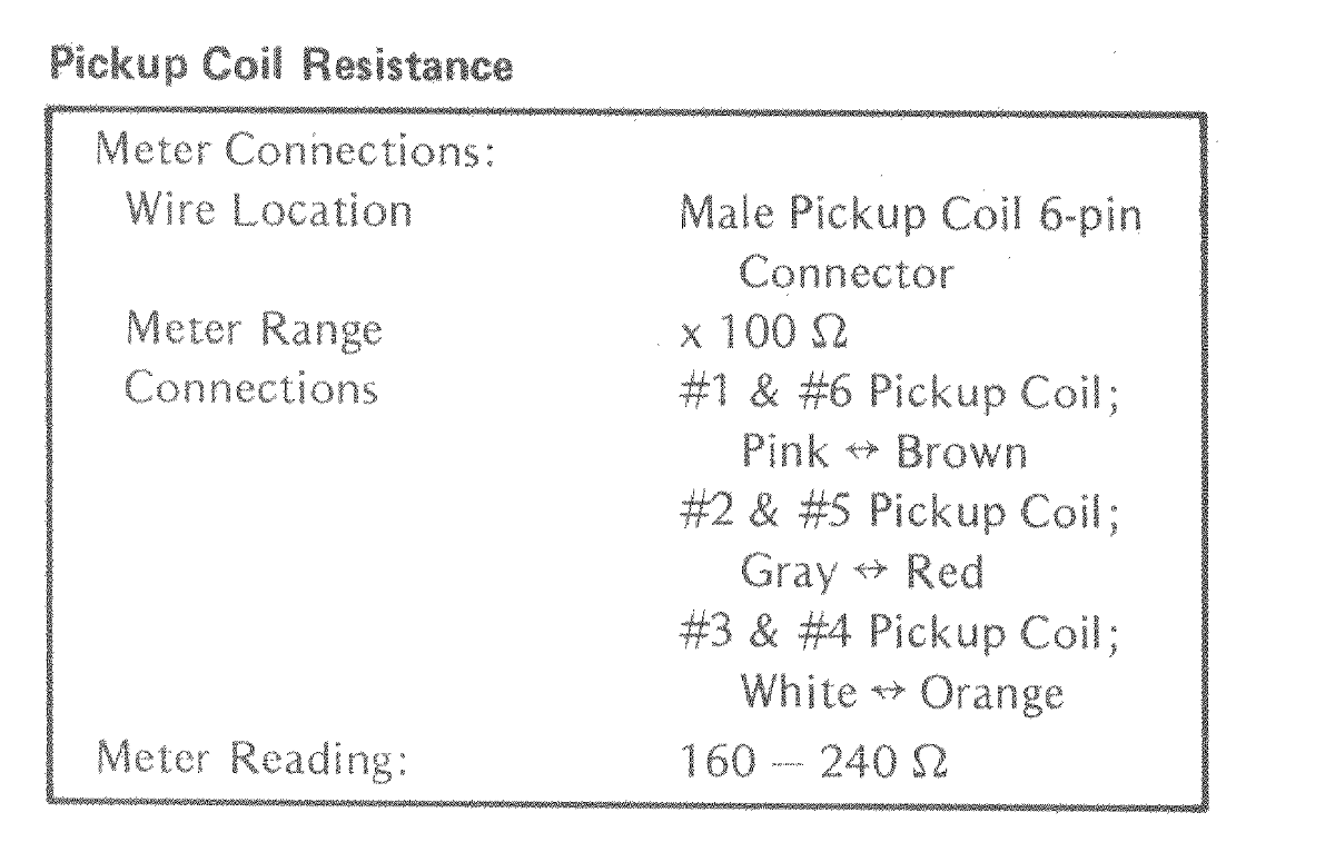

pickup coil wiring as per the ZN Voyager manual-

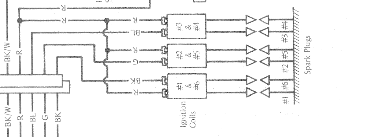

Ignition coil primary wiring as per the wiring diagram from the ZN Voyoager manual

so, regarding the wiring-

The ZN wiring diagram I have shows Blue/Green/Black as per your earlier comment (I added the plug numbers): ??
