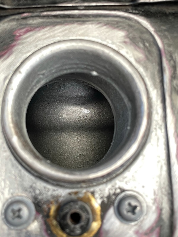

5 years 8 months agoStiggy wrote: For cleaning badly rusted tanks I have used small fish tank gravel and some diesel , kerosene or similar. Put it in shake it around , empty and flush. It will remove the rust scale and debris that would otherwise have fallen off in the longer term in normal use. A good step 1 clean before any chemical process.
Don't put the gravel back in the fish tank. :S :S :S
I used the metal rescue, it gave the gas tank a good clean.
the gas tank look good but I probably have lots of loose rust sitting on the bottom
I will try to clean with baking soda and vinegar and give it a good wash then seal it
Thank you
Eran
1984 Kawasaki Voyager
2002 Honda CBR954
2002 Honda CBR954
- Bar
- Posts: 191
- Thanks: 42
5 years 7 months ago
clean the gas tank with baking soda and vinegar
defiantly help but the tank always stay a bit rusty
after done washing with water I cleaned it with paint thinner and carburetor cleaner
then dry with heat gun really good
I used the POR 15 sealer and it looking good so far
I will wait cupule more days till it completely dry and use it again with gas
