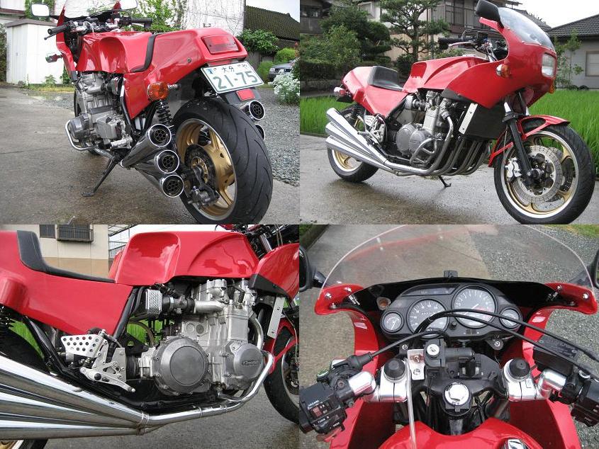

Good luck with the Voyager. They don't have much going for them these days , they are difficult to modify , but they have the right motor
This bike was done quite a number of years ago, and it was a big project.. Probably not what you are looking to do -ideas maybe.

I fitted a ZZR1100 (you guys over there call it the ZX-11) front end to mine, it looks like whoever built that red one wit the 6 megaphones did the same as I recognise the clocks too . On the subject of fork length they were a good 4 inches shorter than the originals so I had some sleeves machined up in steel to lengthen them. And on the subject of the bottom yoke fouling the radiator cap McBoney I had to have a small section machined out of my machined from ally billet bottom yoke becasue of the same. Although that's just got me thinking because it was machined to clear the original cap, which aren't available anymore & I've just bought an alternative one which is a different shape to the original & have yet to try it. Bugger :pinch: Rear wheel widening I got mine done by a fella in Germany about 20 years ago, it takes a 180 section tyre. Modifications to the swing arm were needed too, but they weren't that extreme. I know Kosman over there in the States provide a motorcycle wheel widening service but a friend who lives there had some done for his KZ1300 & he wasn't very pleased with the quality.
