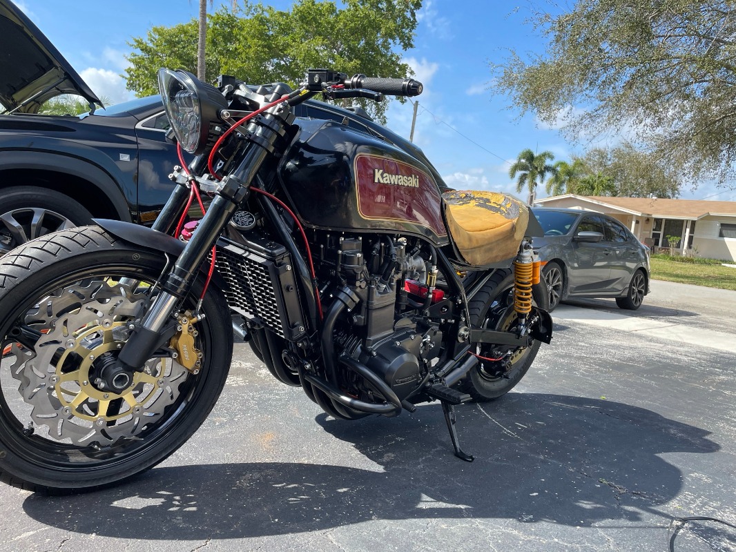

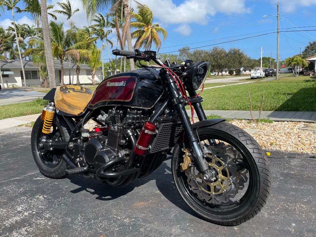

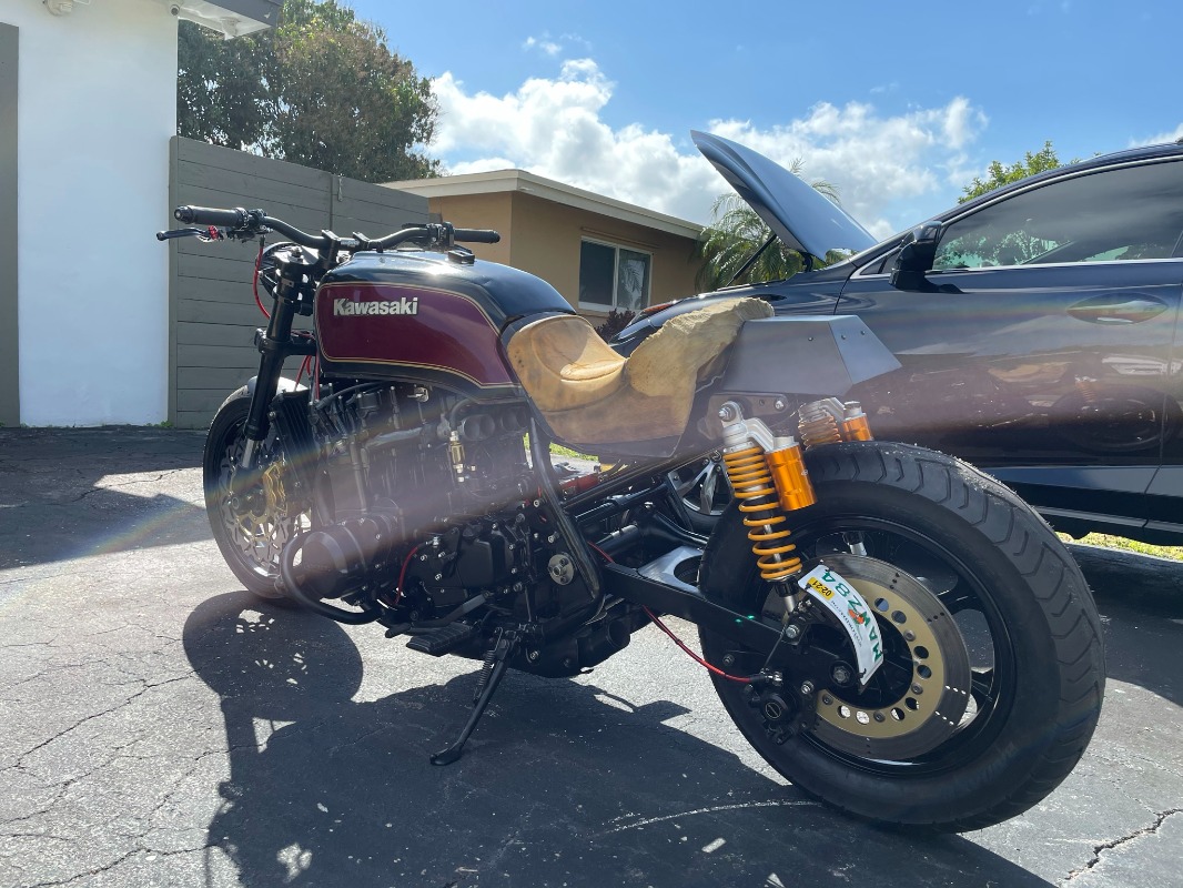

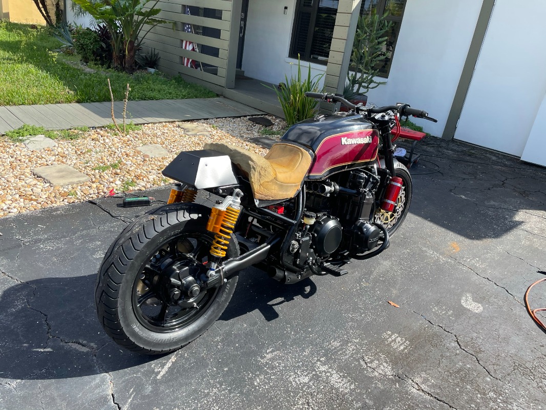

the plan for today was to get the bike on the road for a test drive
I did put it on the road but having an issue with the clutch
It look like its not engaging all the way, i may need to extend the clutch push screw.
for now I will go back to cable for testing
It is not 100% done yet but this will be the final look

- Posts: 974
5 years 8 months ago
It’s looking superb. Lots of interesting details .Well done!
