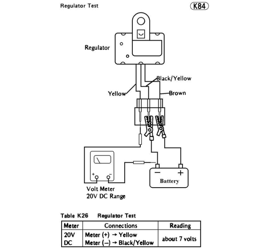

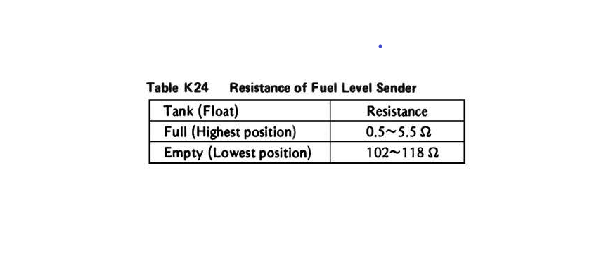

Looking in the ZN1300 service manual for the fuel tank sending unit- it refers back to the KZ1300 manual pages 261&262 for testing. The fuel tank sending unit test is
Also note that the fuel level indicator and the water temp indicator are powered by a limited / regulated voltage circuit and the test for that voltage regulator is looking for "about 7 volts"
