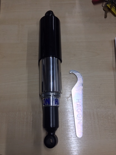

In the meantime, some goodies arrived!
Interestingly the springs have a different finish: one is gloss, the other matt. I have requested another, no matter which, as long as it matches one of the ones I already have.

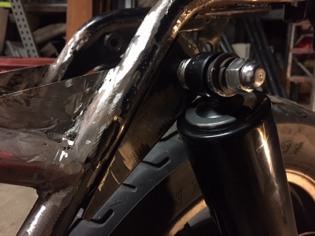

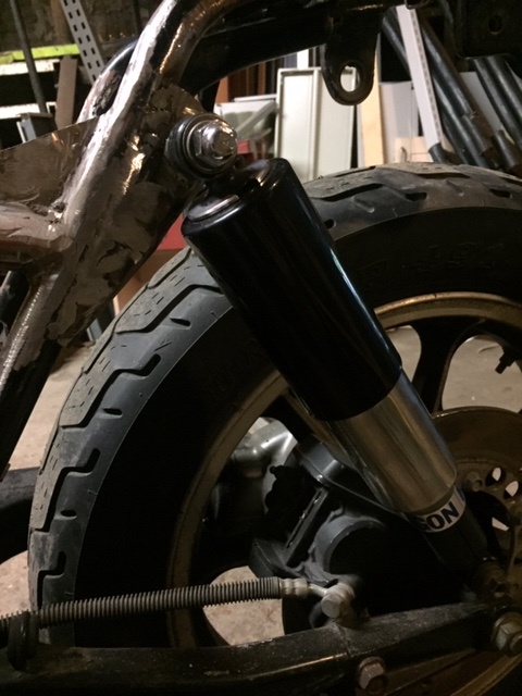

Grr... this is what you get when you are fabricating without all the parts available.... shock top touches the mount.
The hole for the shock mount is a few millimetres too deep into the metal triangle.
Only way to rectify that is make new ones...

Getting there Paul! The weekend is in a few short days, I'm also hoping for some time on my bike.
The shocks look similar to stock. Except the springs. I think they will look good on the bike. But why they would send one gloss and one matte puzzles me, but not unheard of suppliers mixing things up.

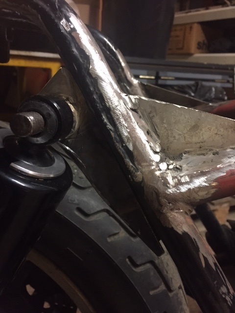

Made some progress this weekend.
Instead of making new shock mounts, I dropped a weld inside the corner of the mounts and shaved the outside off sufficiently to clear the shock. Then welded both mounts in. I still need to tidy it all up and plug a few holes in the welds, but I will do that when I have the engine out and am prepping the frame for paint. For now I just need it to be fixed.

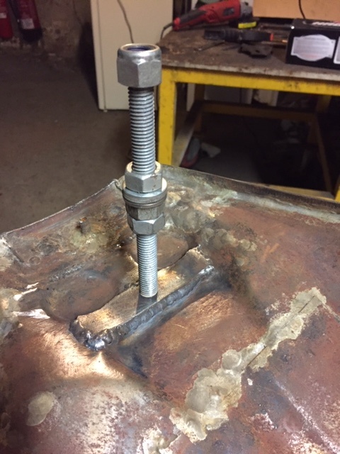

I have also asked the resident welder to weld a plate and a pin onto the bottom of the tank. That will enable me to clamp the tank in place against the frame. The front pins and rubber mounts I did last week.
