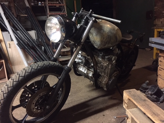

7 years 2 weeks ago - 7 years 2 weeks ago

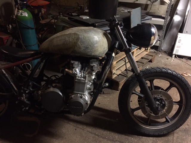

Right, I mounted the headlight..... I'm not sure... I think it may be too big!
Also, not sure about the mounting. Currently I have it on the bracket that supports the fairing, so it doesn't turn with the forks. It may be better if I get two side brackets and mount them onto the forks...
Anyway, This is how it looks.

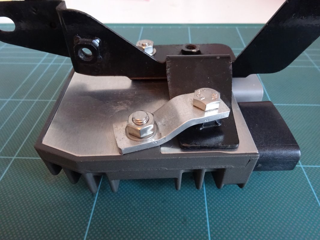

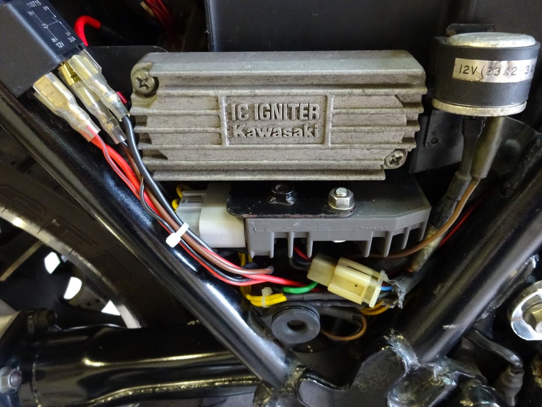

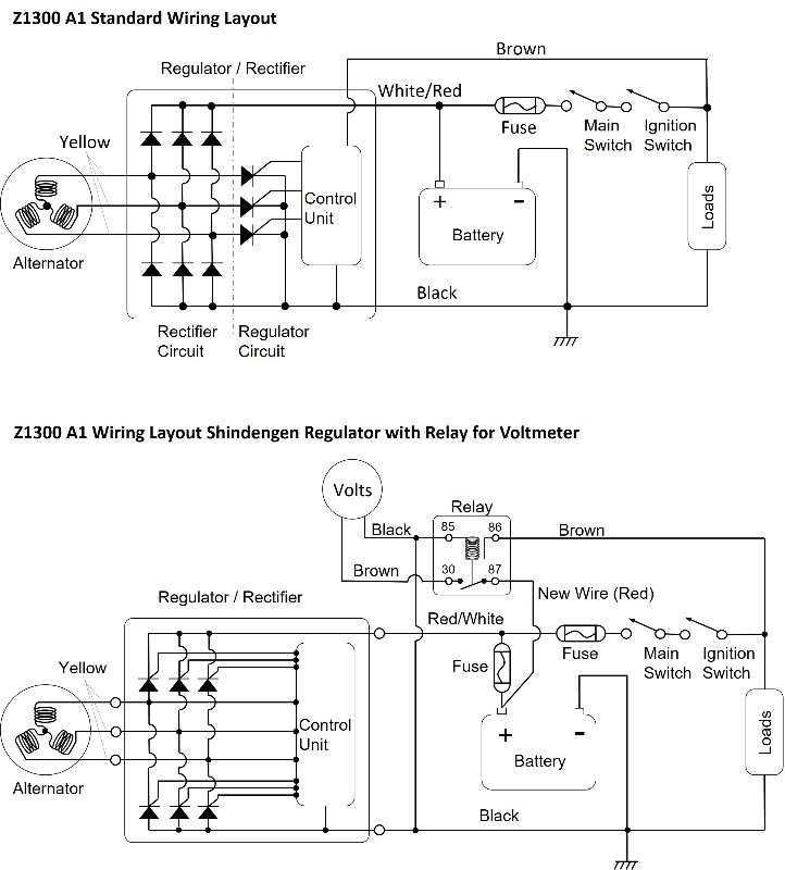

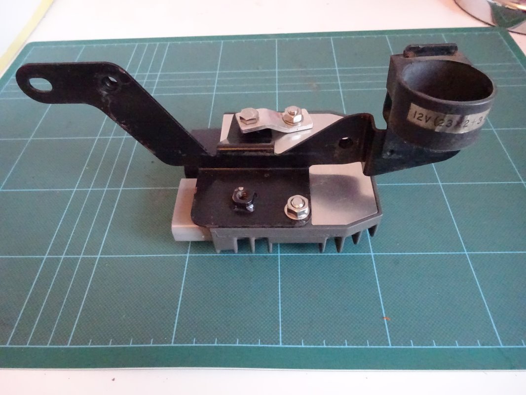

I would agree that there are many fake Shindengen regulators on e-bay. There is no such thing as a 'cheap' Shindengen unit. I bought a Shindengen SH775 series unit to address my perennial 79 stator overheat issues and have been very happy with the solution. The only challenge comes in fitting it, as even the 775 is much bigger than the OEM fit unit. I have no idea where one might find space to fit the SH847 as this is enormous.
The 775 does not fit between the battery and the side cover if positioned with the connector facing outwards so I rotated it by 90 degrees with the connector facing the back where it fits with a small clearance between the frame tubes. Pics and wiring diagram below:

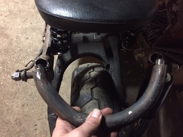

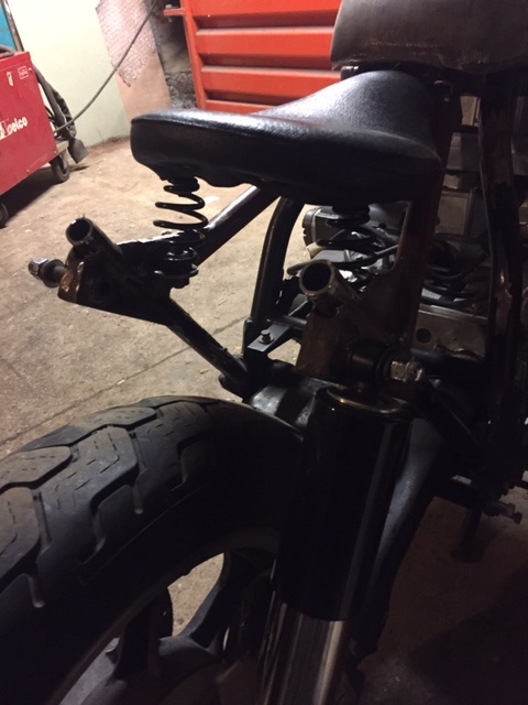

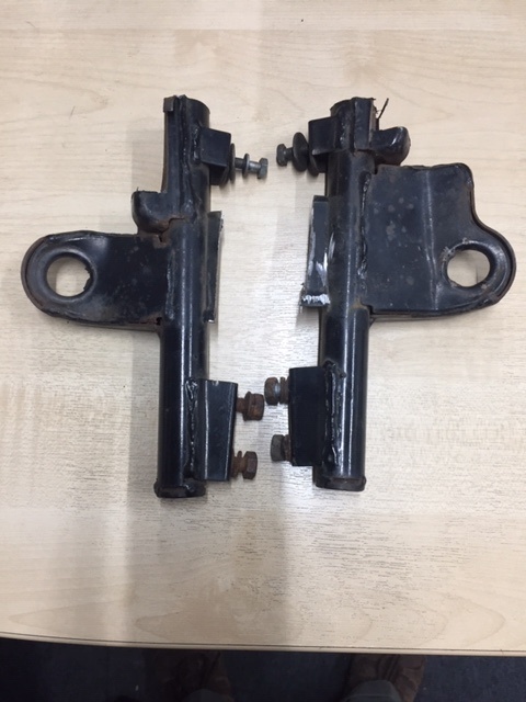

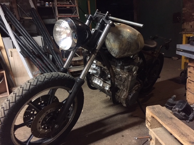

Ok, no going back now!
Rear section cut off. Hoop needs a little more alignment and then welding in.
That would then be most of the structural welding done.
On the headlight I have decided to await my new forks and see what the situation is then. These will be 58cm dia so will stick out a little more. Then I'll get the clip-on handlebars and decide whether I'll mount the light with one bottom bracket to the frame (non turning light) or two side brackets to the forks (turning light).
Cut off sections will go to Canada tomorrow.
