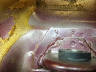

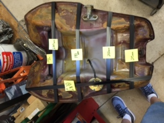

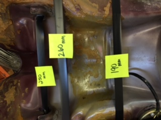

My thanks to all for the responses. As always, I will try to respond to the latest comments in one shot. The tank was not attached when I purchased the bike, so I have no way of knowing if it is the correct tank. Regarding measurements; those provided to me helped a lot. I have measured my tank in the same manner and will post those pictures. I included the dimensions of the mounting pucks on the frame. They are an inch and a half narrower than the distance on the tank. I also included the number on tank in one of the pictures.
I hope these pictures help. Please continue to help with this bizarre problem.

In reference to the third photo down from the top, either my eyes deceive me, or there is a photographic illusion. The bottom of the tank behind the tape marked "190 mm" appears to be bulging downward. There also seems to be a line in the paint on that area that would be made by the backbone of the frame hitting it.
Your second photo from one week ago shows the same downward bulge in the bottom of the tank.
The apparent amount of downward displacement is exactly the distance and in the correct location to hit the frame backbone and hold the rear of the tank up.

10 years 2 months agoglobemaster wrote: In reference to the third photo down from the top, either my eyes deceive me, or there is a photographic illusion. The bottom of the tank behind the tape marked "190 mm" appears to be bulging downward. There also seems to be a line in the paint on that area that would be made by the backbone of the frame hitting it.
Thats my suspicion as well that the tank has been pressurised and "popped" out in a few spots.
