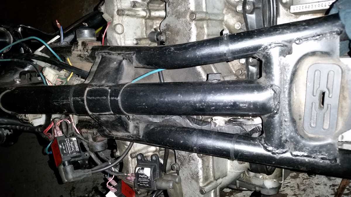

I've never encountered a heat barrier under my tanks. I have had 3 now. 79,80,81.
I have NO idea why your tank won't fit. With the crap mess of coils and wiring under my current tank you'd think I was a candidate for a poorly fitting tank but nope... like a glove.
Do you want me to post pictures of the underside of my tank and frame for comparison?

To LedKZ1300: Yes, please. Any pictures of other tanks are helpful.

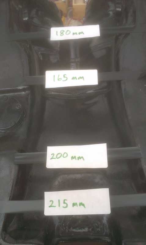

- charlie9670
- Posts: 235
- Thanks: 11
Re: Fuel tank blues
10 years 2 months ago
Tried to get some measurements of the tunnel on my spare tank, not easy to measure accurately with an old tape so maybe not much help but I'll put it on anyway.

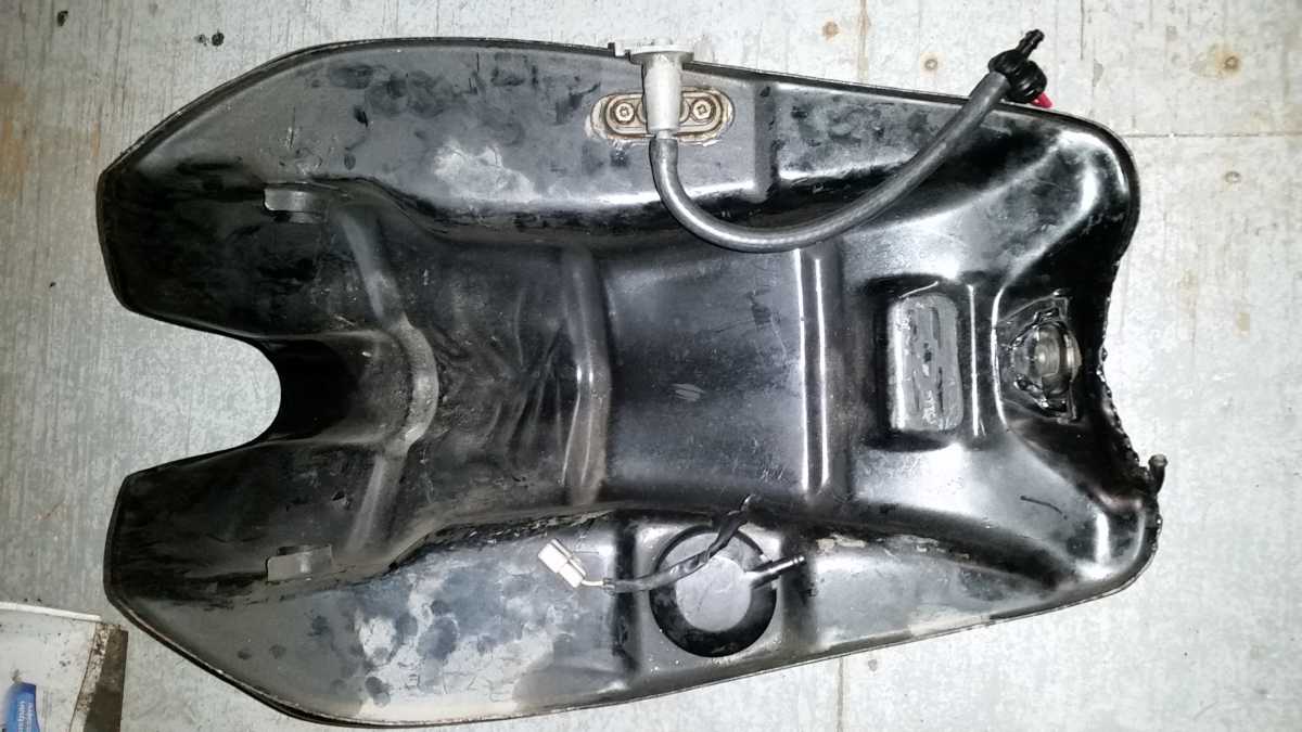

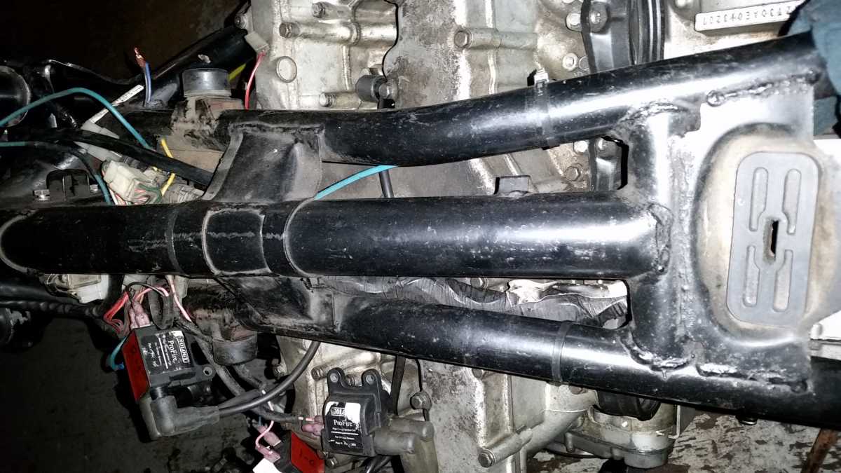

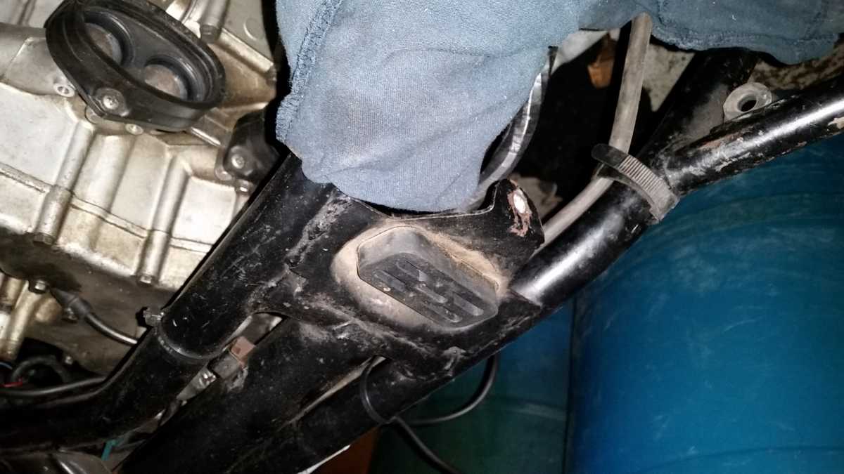

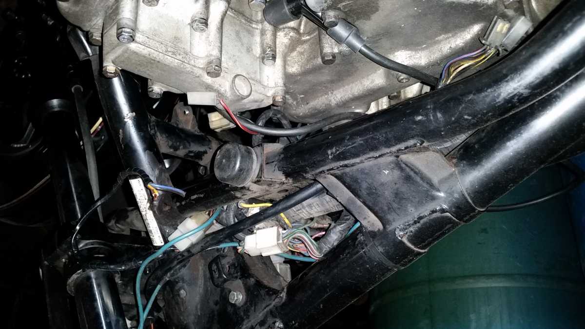

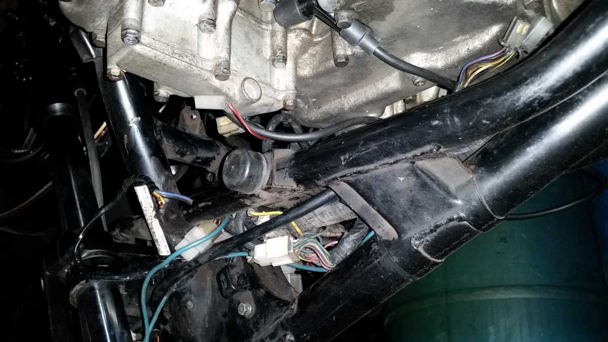

- Ledkz1300
- Posts: 627
- Thanks: 71
Re: Fuel tank blues
My 79 tank is full and has fresh paint so I can't flip that one over until its empty. Here are a few pictures of my 81 tank underside and frame for comparison.
