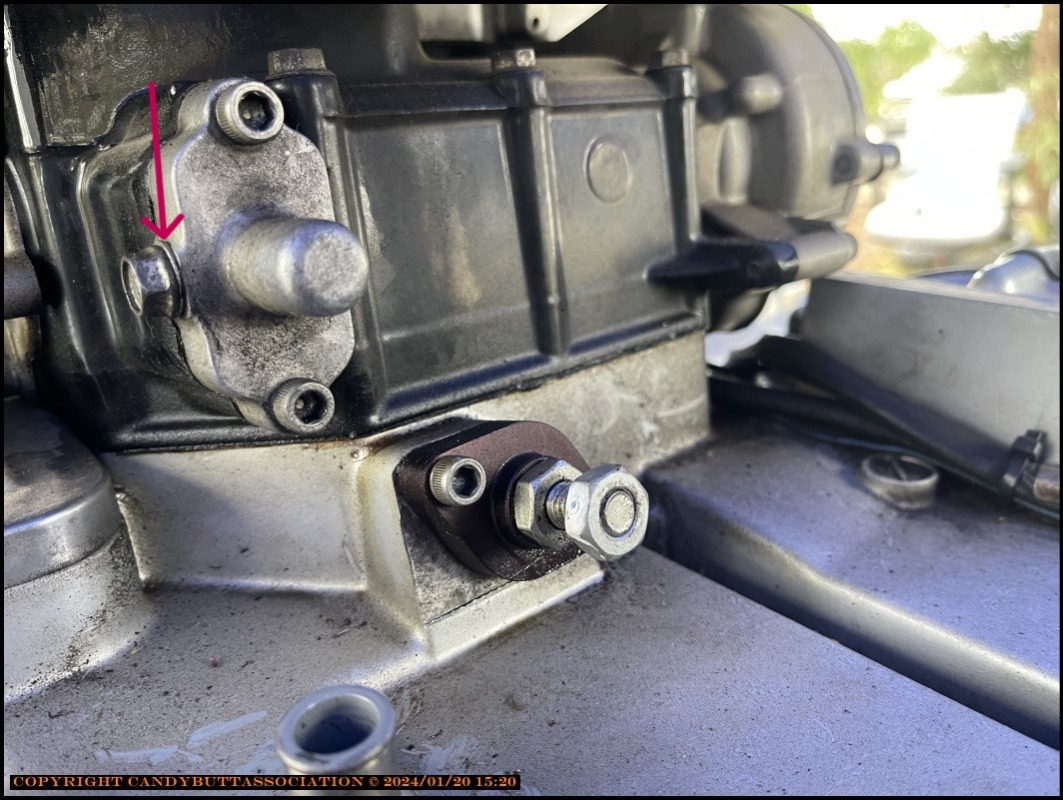

Do you have a washer on the tensioner bolt?
I found washers on the screws of my tensioners and what they did was make them useless, only the spring acted.
Without the washer, the tensioner is blocked, preventing its return.

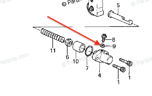

Mine does have a washer behind it. Partzilla shows it having a washer.. I wonder if your washer is incorrectly sized?
This exploded drawing corresponds to the chain tensioner that drives the camshafts.
Not the chain tensioner that drives the water pump and the pickup.
