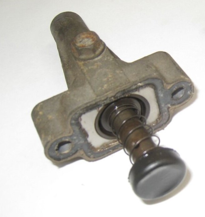

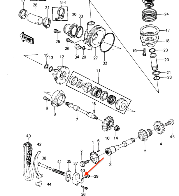

The washer should be on the timing chain tensioner bolt.  It is an oil sealing washer.  Kawasaki part number 92022-077.

2 years 9 months ago
In my case I found a metal washer, its thickness prevented fixing the tensioner plunger after adjusting the tension.
In no case did I find a washer of oil sealing material.
On my other KZs the tensioner can be locked by tightening the nut, preventing any teeth from jumping during a strong reduction.

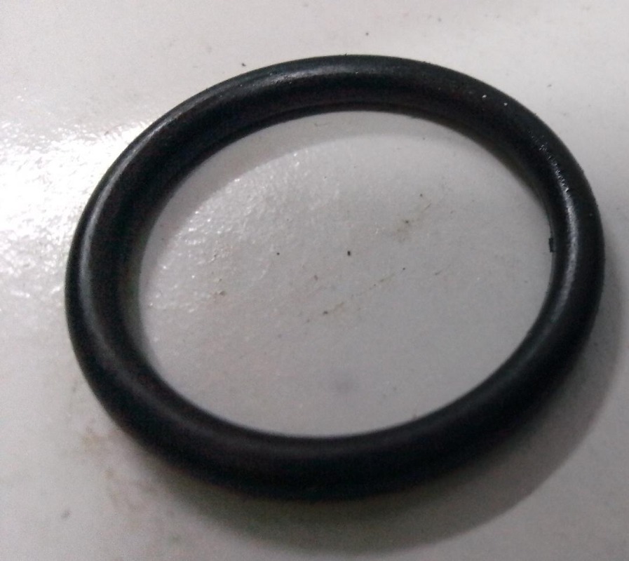

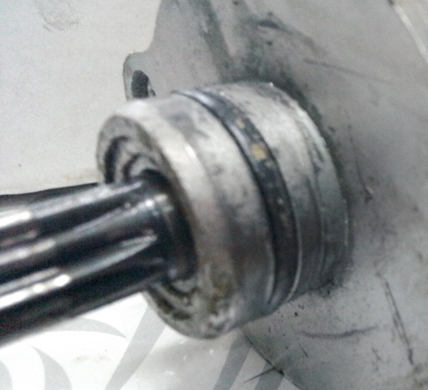

2024-01-24 Oil Seepage, Starter Motor, Timing CoverWhat's behind the timing cover. Sealed by O-Ring.O-Ring shape? Looks flat. Need to see if Rick's comes w O-Ring or not. [img]https://candybuttorg.ipage.com/pix/motobikes/wrenching/KZ1300/2024-01-24 Oil Seepage, Starter Motor, Timing Cover/6.jpg[/img]

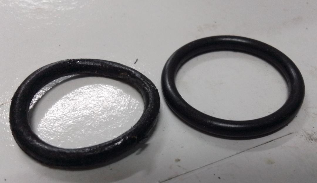

I bought a complete engine gasket set that also included the O-rings.
This is the starter motor gasket, it is round.
On the left of the photo is the old rubber.
