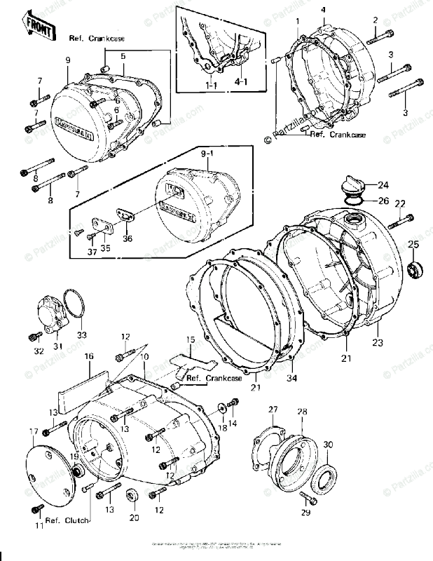

2024-01-20 Oil SeepageWhat's behind this cover? Anything going to spring out?
Partzilla doesn't show a gasket for it...

Re: Oil Seepage
Item #33  -  45mm o ring behind the timing shaft cover (which is the access for removing the timing shaft sprocket). Just crankcase pressure .if you have to remove the tensioners do so very carefully and don't move the crankshaft until the tensioners are back in and confirm the camshaft timing before turning over the engine.

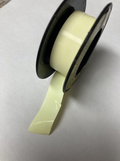

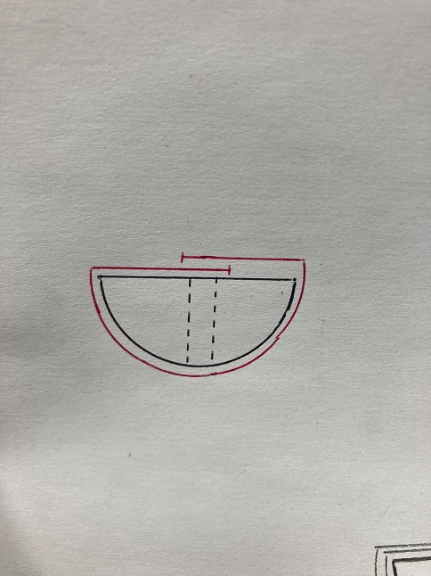

Re: Oil Seepage Cam Cover end-plugs
This solved my weeping issues MANY years ago. This "Pipe Fitters" tape is much thicker than standard "Teflon" tape.
Last edit: 2 years 9 months ago by scotch.
Well, that's a great idea! Thanks. I hate to pull the valve cover again.. but I hate leaks even more.
