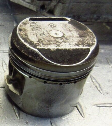

Interesting note that there are an addition 6 oil drain back holes below the oil scraper ring plus the same 6 holes behind the oil scraper ring
Early 1300 were known oil burners - I was under the impression one of the 'fixes' in later model 1300's was to increase the number of oil ring land drain holes???
Early 1300 were knows oil burners - I was under the impression one of the 'fixes' in later model 1300's was to increase the number of oil ring land drain holes???
You are correct. They fixed the problem and the zn1300's got an additional 5 drain back holes below the oil scraper land.
