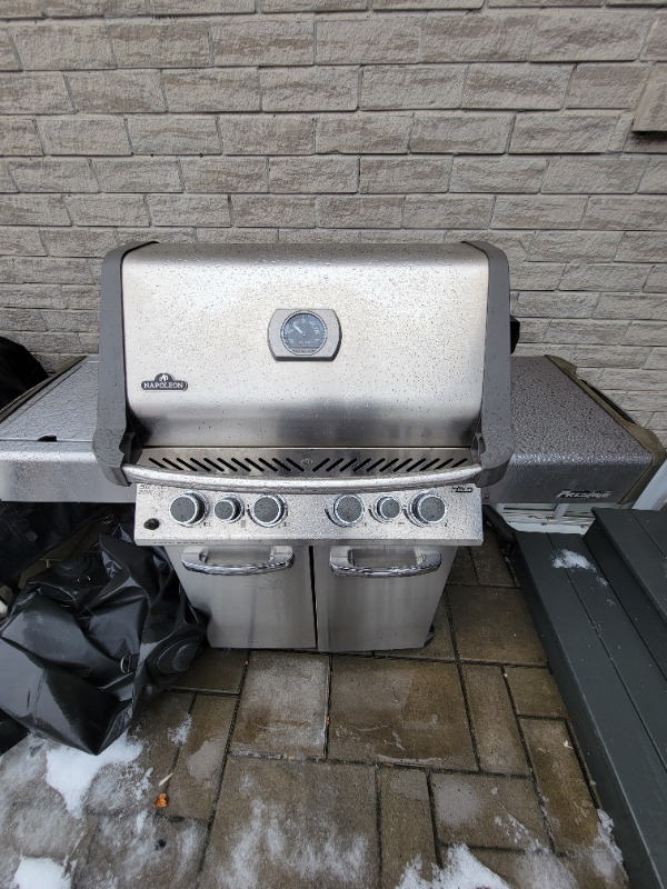

Just because it's winter in Canada, doesn't mean that we don't go outside and use the BBQ.

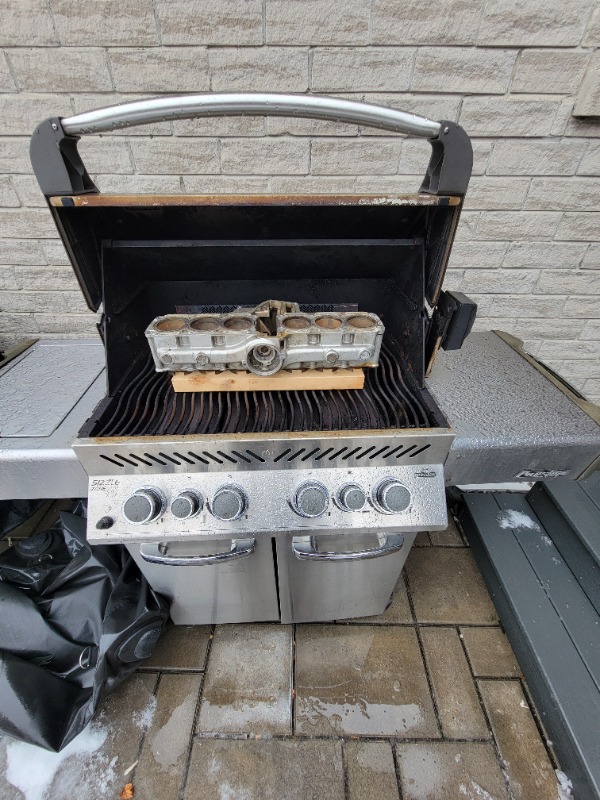

Today we are cooking a cylinder block
Set BBQ temperature @ 300-350 Deg. F
Place cylinder on a piece of 2 x 4
Cook for 30-40 minutes

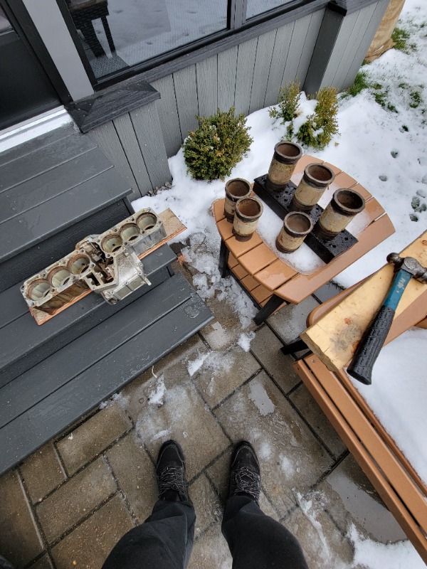

Turn cylinder block over onto a piece of plywood, top side down and allow cylinder liner to hang over the end
Place a piece of 2 x 4 on top of the liner and hammer out with a 12 oz. hammer. 10-12 good solid smacks.
Once the liner is flush with the bottom of the cylinder block, grab the cylinder liner from the top and twist / turn it out of the block.
Repeat
Bob's your uncle , Mary's your aunt
Temp set at 300F
Set up in BBQ for heating
All done. 1 Hour later.
allow to cool before bringing inside, 1/2 hour.

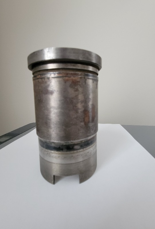

Any chance of close up pics of the liners? And o-rings?
- Posts: 3298
Re: Cylinder sleeve removal / replacement
2 years 10 months ago
This pic was taken after 20 minutes of clean up with a green Scotch Brite pad and a piece of 400 wet and dry paper. The top o ring looked more like a square o ring and completely filled the o ring groove. The 2 bottom o rings were still subtle and remained in the cylinder block.
Still in good shape and could be reinstalled. If the cylinder sleeves come in at a rediculous price, that's what's going to happen. I'll clean everything p and put back together. It's all about the journey.
