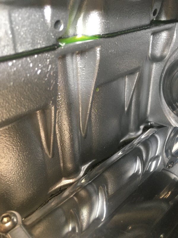

I've been waiting about 1 week to post this. Needed some time to sort things out - or attempt to.
This is unedited copy-n-pastes between myself and "Italianmetals". The source of my head gasket (kit)

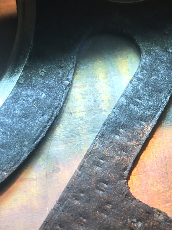

So as I continue "Chew on my own words" you can read the following (I sent the following photos also) and come to your own conclusions.

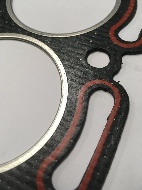

To: Italianmetals. I purchased this gasket set: ORDER DATE May 22, 2020 ORDER NUMBER 332681059899-1767730477014

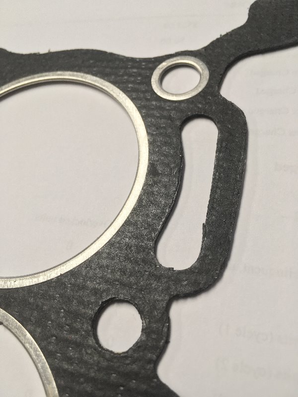

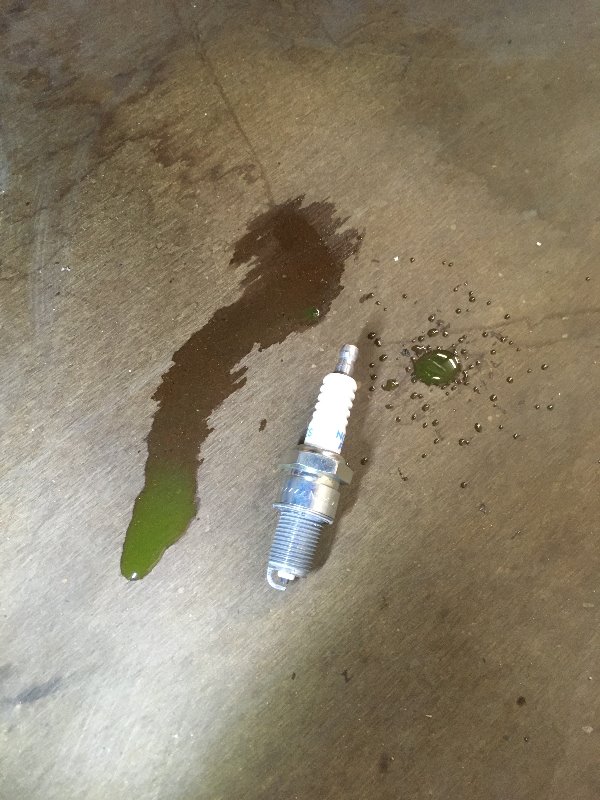

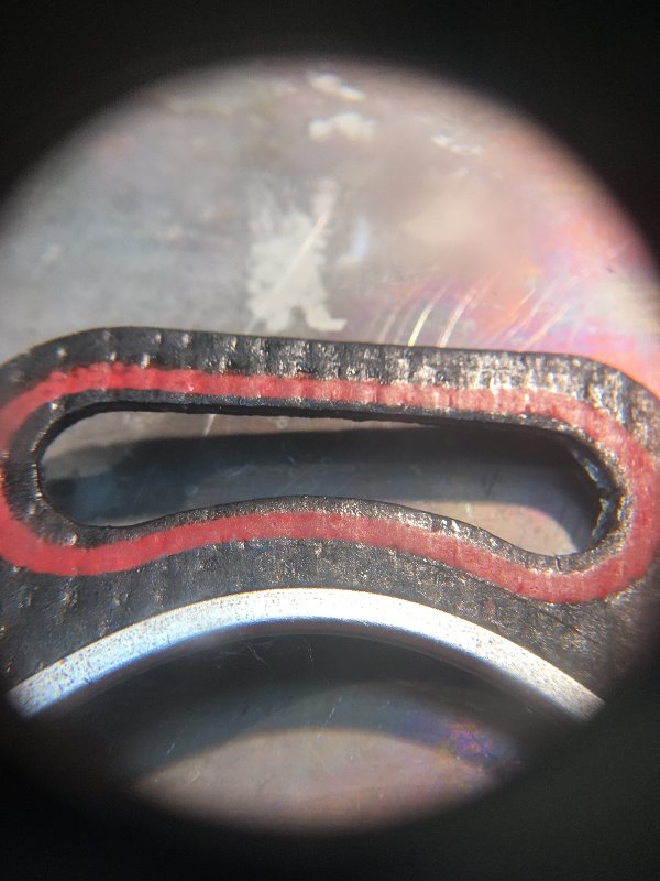

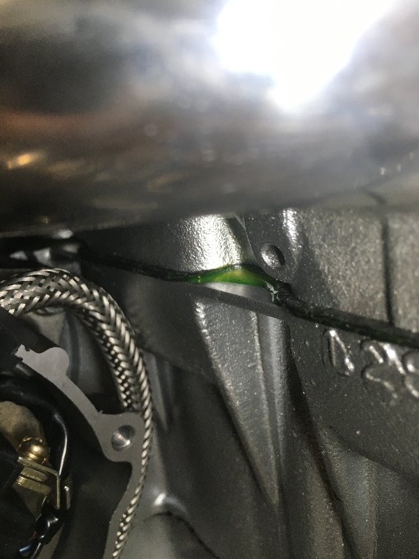

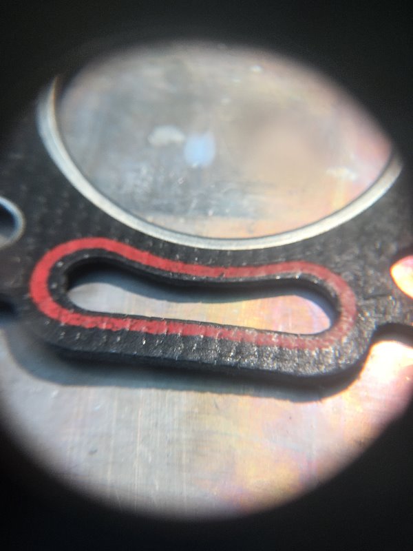

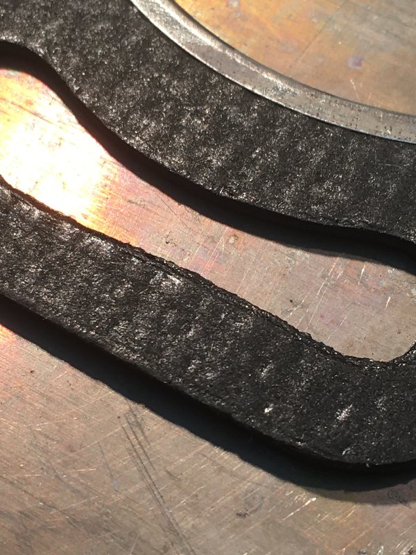

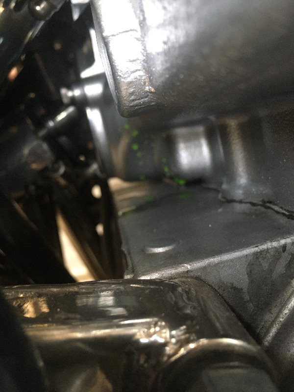

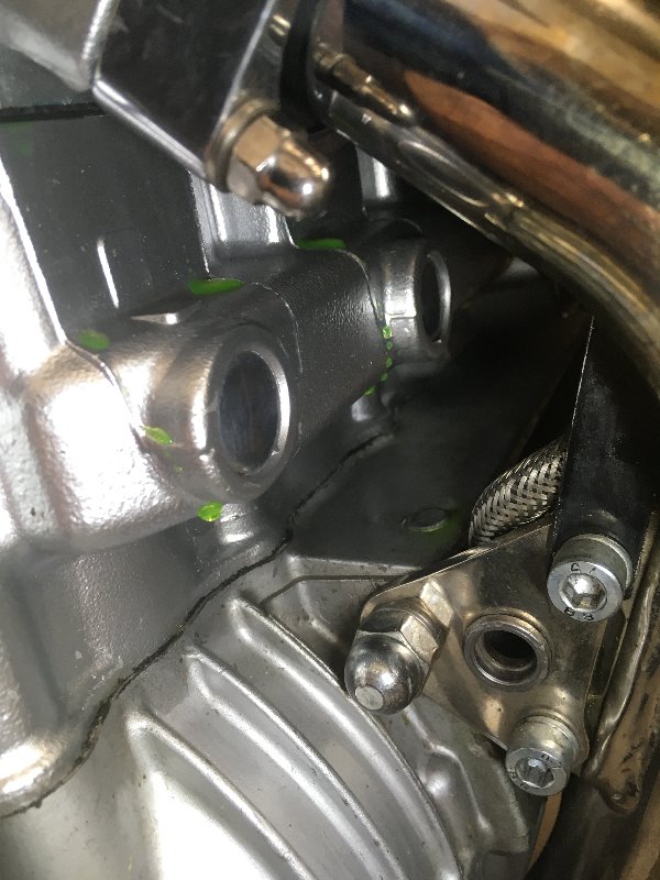

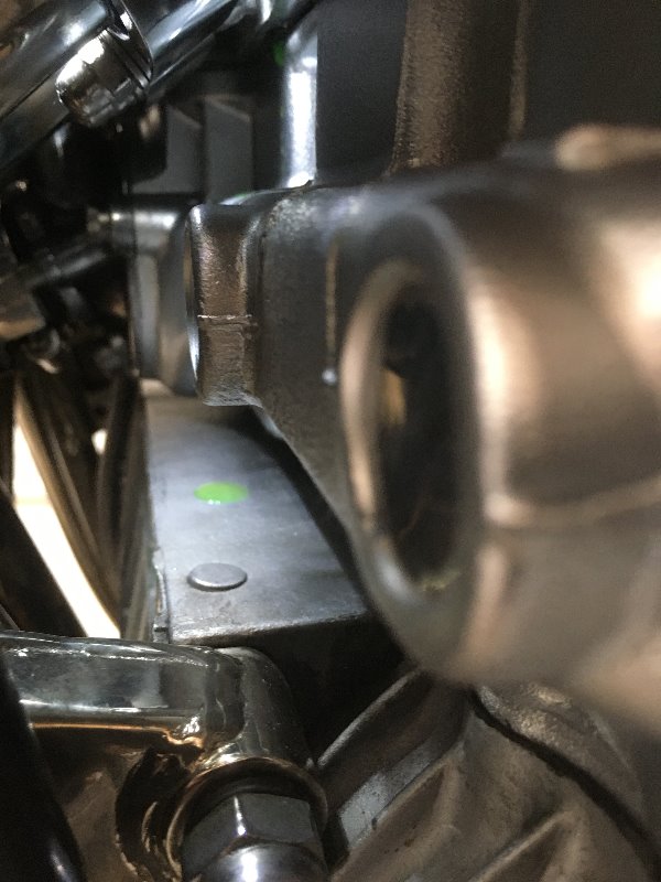

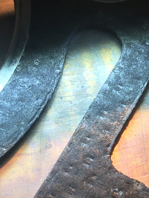

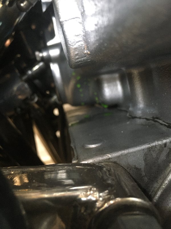

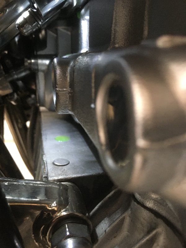

I purchased this gasket set well in advance of a top-end rebuild inclusive of New Valves, cyl-head work including "shaving" the head. It took this long to collect all the parts required. Last week I assembled the engine using your head gasket. Within minutes of filling the cooling system the gasket started leaking all the way around. Torque was checked ( Done per the manual). I torqued an additional 5lbs and the leaking continued ! Today I tore the top end apart and was disgusted with the head gasket ! The "enbossed" pattern did not "squish-out". The only indication that this gasket had been installed and torqued was by the fact that the silicone seals around the coolant ports was completely compressed AND had the embossed pattern inbedded in them. So in other words - The very nature of the material used and the embossed texture allowed coolant to pretty much go where ever it wanted ! This head gasket is garbage. I've supplied photos. I requesting a refund based on this explanation with the photos as proof. I am expecting a response. ! I am hoping I won't have to pursue this further.Respectfully, at this time. wcmic

and .....I forgot to mention: The exhaust Gaskets are too large to fit into the head !So much for your German engineering.For the record: I am the original owner of this '80 1300.....so I know what I'm talking about.

That's the end of the correspondence and I'm the FIRST GUY !!!!! "Well - Don't I feel freakin' lucky!"

Looking at your pic, even where the red silicone? was applied, it didn't fill in the voids in the gasket material. The bottom side of the gasket should have also had the silicone fill IMHO. On top of all of this Italianmetal didn't offer up any resolve to the issue. Didn't ask how you installed the head using ..... Terrible customer support. I feel your pain.

Tbh the red 'sealant' around the waterways looks to be a token gesture, the OEM version has a proper bead of silicone (?) that is at least 1 to 2 mm thick both sides. Pattern gasket makers don't seem to be able to replicate that. Good news that OEM cyl. head gaskets are still available.
Prior to installing, the red sealant was a raised bead - about, but no more then 1mm. And to be clear - The leak was "static" - No cap, No pressure. Hadn't even got to the point where I would crank-up some oil pressure prior to opening fuel and starting.
