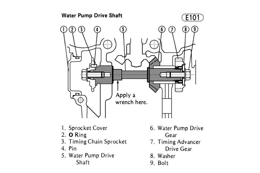

is there better access to the nut on the inner end of the impeller pump shaft from the underside of the block? If there is I will take the block off.
I've bought a stainless steel shaft and new mechanical seal from zed-parts.com (in UK) and cannot get the nut off the end of the shaft. It needs two 12mm open ended spanners on the shaft and the nut but I think my nut is rounding.
I've taken the timing shaft out but the nylon bevel gear can't be removed until I get the impeller shaft out - this means I can't use heat on it

4 years 3 months ago - 4 years 3 months agoIf you have the timing shaft out ( which is called the water pump drive shaft by the manual), can you not get a 6 point socket on the troubled nut. I can see where you would have to use an open end wrench on that nut if the water pump drive shaft was still in place but you have it out?is there better access to the nut on the inner end of the impeller pump shaft from the underside of the block? If there is I will take the block off.

Thanks, I have that shaft (the grey timing shaft) removed already. The nut I'm trying to remove is the one going forwards (between 5 & 6 in that image. Unfortunately the nylon bevel gear (part 6) cant be removed until after the impeller shaft comes out.
I googled a few images and it does look like access is much better from the underside so the barrels are coming off. New base gasket and 'O'-rings going on order too. Not looking forward to battling with the rings going back in
