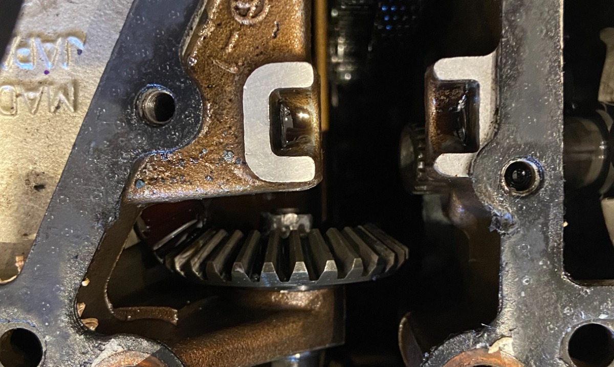

So you can't get a 6 point box end wrench on that nut with the water pump drive shaft out?? Those 2 shafts , water pump drive shaft and the water pump shaft should be on the same plane, so I'm struggling to see how a box end wrench won't go on, now that the drive shaft isn't in the way.

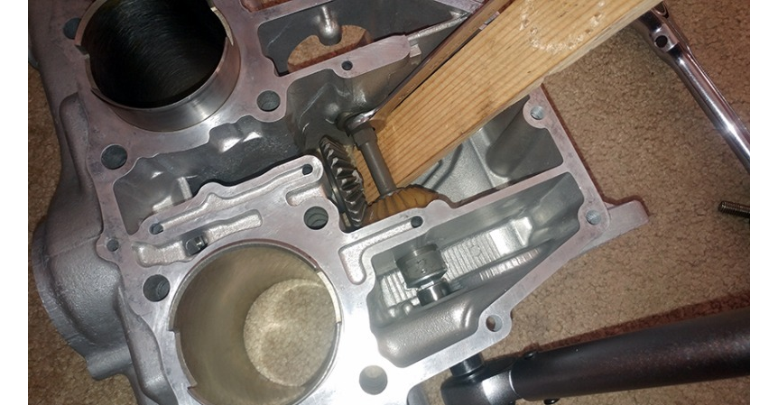

A picture of the access for the water pump shaft from the bottom side of the cylinder block. Just for reference.

unfortunately I only have two 12 point (ring) and open end combination spanners. I don't think I have ever seen 6 point ring spanners but if I don't get it removed once the block is off I will take the block to my trusted professional bike shop.

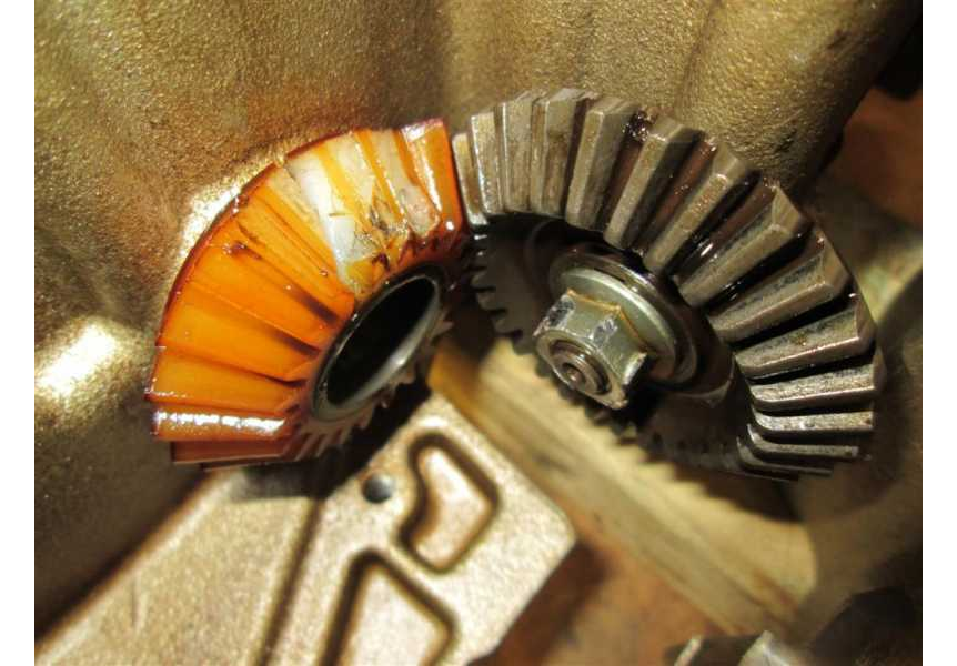

This image I managed to grab from a previous post but what it depicts is exactly what happens when you try to break free a tight fastener with 12 point drives. 12 point drives only bear down on the corners of the fastener and will always damage the corners such that the bolt or nut should be replaced rather than using again. Snap-On specifically made their wrenches and sockets with reliefs in the corners of the wrenches and sockets so that their tools could not damage the corners of the fasteners. The only drawback to Snap-On is the price of their tools. $$$$. and one would argue that you get what you pay for. They call it their "Flank Drive System" ( and no, I'm not rich enough to have Snap-On tools)

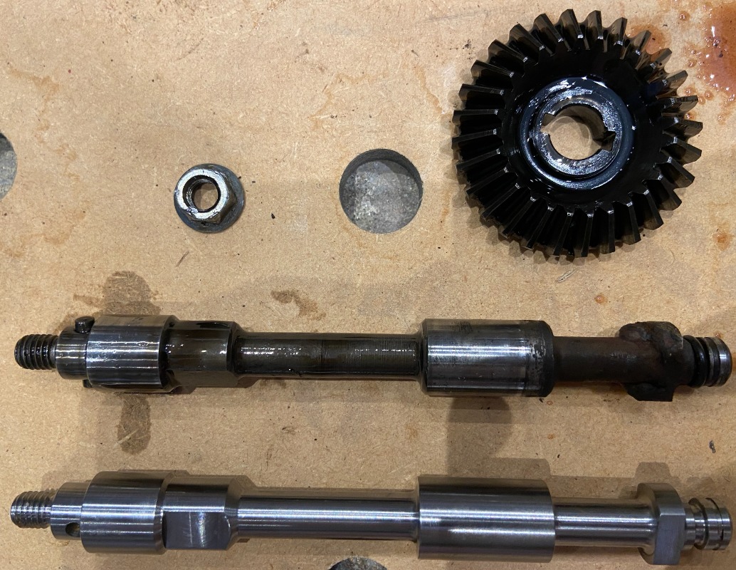

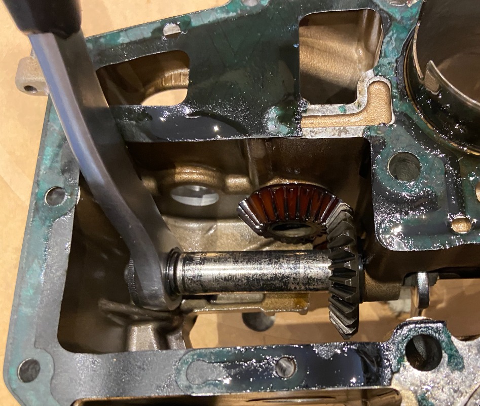

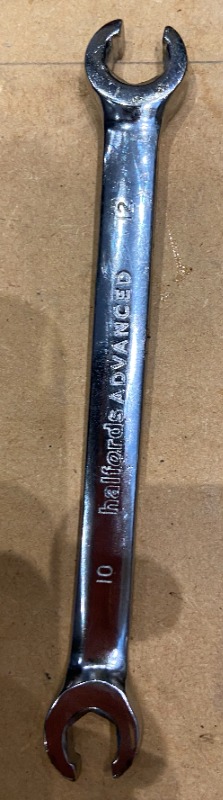

I treated myself to a new open flare spanner but that did not help. There just isn't good access to the nut from above. I took the block off and found that a 6 sided long reach 3/8" socket is a near perfect fit between the nut and the rear of the cam chain chamber., It's all out now and a new flanged nut has been ordered

Glad to hear that you managed to resolve the issue. Obviously, the pics I was referring to are from a different engine casing and I now can see your dilemma. Tight spot for sure. Kudos !! Hope it's all down hill from here. if nothing else, it was a good opportunity to talk about the advantages of the 6 point drives. Thanks for that.
