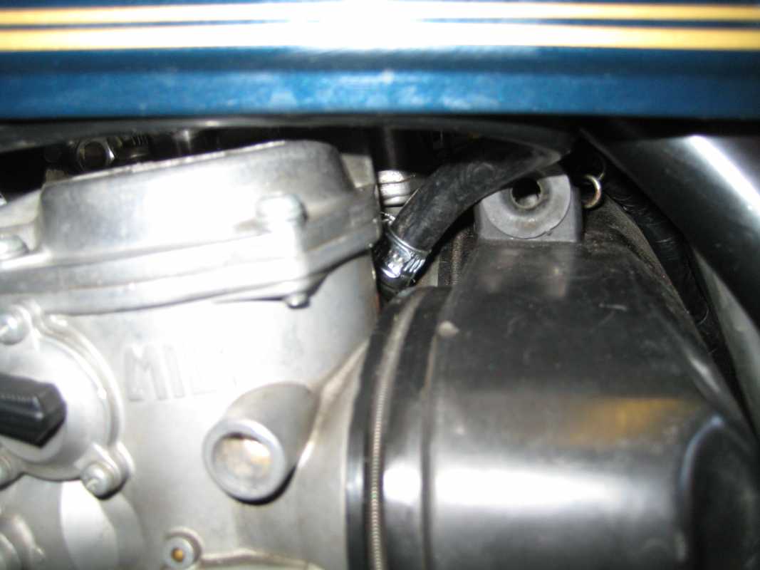

At the inlet.

At the inlet.

At the 'bend around the corner, RHS of bike.
