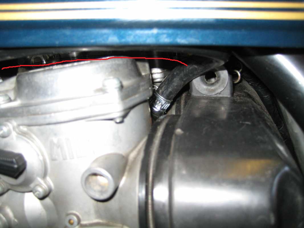

I really don't think its the length of fuel hose, it is not 5 meter, it is 20-30 cm
from what I see the fuel line is curve up a bit and that can be the issue.
may be the aftermarket fuel valve (or however you want to call it), is sticking down too much and this cuase the curve

One thing that could plague a person without the knowledge or attention to detail could be if the fuel line rises above the bottom edge of the tank in vertical height. If you were near empty and went down a hill, the tank outlet could be above the fuel level and allow air in to the fuel line. That air bubble could effectively stop the fuel flow. Without enough pressure to push the fuel up and over the hump in the fuel line, fuel will not flow.
I'm sure all of us at some point in time got stuck for fuel and was forced to syphon fuel from a car gas tank with a piece of garden hose and we all know that if the hose in the tank isn't kept bellow the fuel level, you lose the syphoning effect and the fuel will not flow over the hump in the hose at the outlet of the tank. (God I can taste the gasoline right now !@#@!)
There are times when it's possible to get an air bubble in the fuel line and as long as the fuel line has a positive rise to the tank, the air bubble(s) will find it's way back in to the tank. If the fuel line has a solid column of fuel and no air bubbles, literally all the fuel in the tank will find it's way to the carb due to the syphoning effect but that's impossible because the bottom of the tank is relatively flat and at some point the tank outlet will eventually find itself above the fuel level and air ingress is inevitable.
