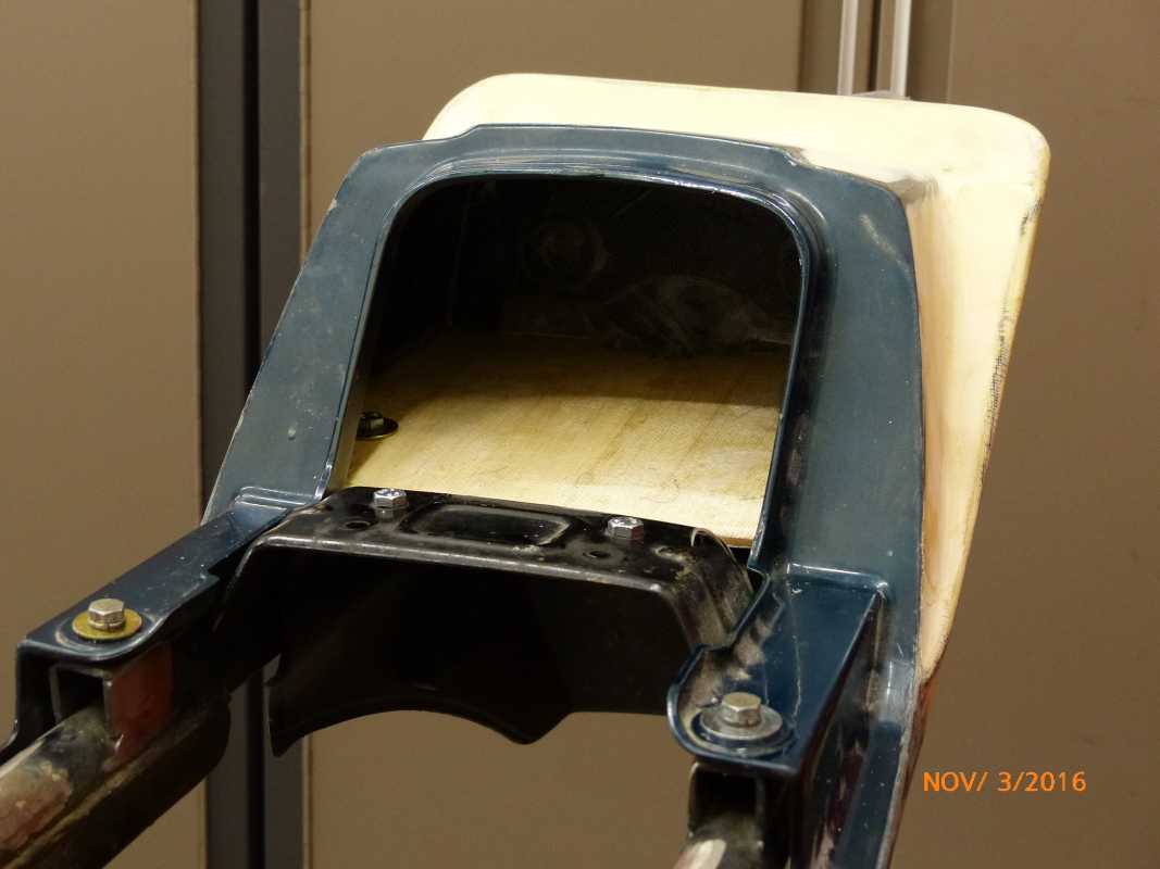

Anyway, a brief catch up here. My goal has always been to spoof my KZ to look like a CBX complete with a Candy Glory Red paint job. One of the "mods" is the tail section. I've built the CBX wing on the back with balsa wood and epoxy fiberglas. It's almost complete short of a little fairing work with the epoxy and micro ballons. That portion is coming along nicely.
In one of the previous posts "Trikebldr" commented on my glass work and suggested that I glass in the storage compartment and ditch the tiny plastic tool box. So it's his fault that I did it. I built the floor of the compartment out of 3/16" balsa wood sheeting and epoxy glassed both top and bottom then fitted it into the tail section and epoxied it in. Than I glassed in the rear of the tail section and that created a sealed in tail section. The tail section is so rigid that I was able to eliminate the 2- 6mm bolts in the back of the section which bolt to the rear light bracket. Now there is 4 bolts holding the tail section to the subframe.
Some might ask "1/4" balsa wood, must be flimsy? " Nope, it's not. I can push down on that wing on the rear of the tailsection and lift the front wheel off the ground when the bike is on the centerstand.
Any way, here's a pic of the new cavernous storage in the tail.

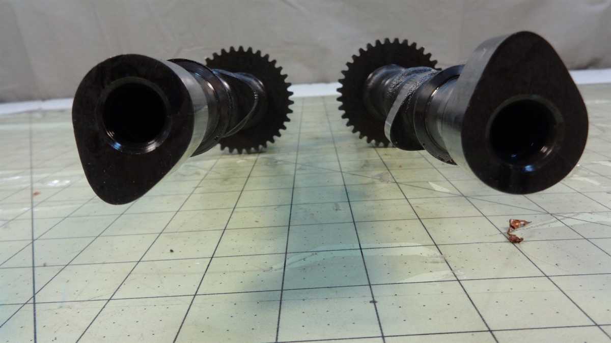

I had an interesting conversation with Delta Cams regarding welding and regrinding my camshafts. After understanding what I had to work with, they proceeded to inform me that they had previous experience trying to do this type of work on the KZ cams and it was all bad. They determined that the cams were made from sintered metal casting and that no welding process would work on them. They said that as far as they are concerned any damage on the cams would render the cams scrap.
Now I did have a set of cams reground to .350" lift and 280 duration but when the shop did this, the base circle of the exhaust cam lobes was almost gone and the intake lobe base circle was almost gone, so those cams are probably scrap. I could install valve lash caps on the end of the valves and probably get things back in spec, but that would be a bastardized set up.
I do have a plan forward. Currently a set of stock cams would fit and I could shim with 2.05mm shims but then when I go to adjust the valves down the road, there won't be any shims left available to shim with (possibly 2.00mm but that's all) I need to find about .028"-.032" of clearance to get back to using shims in the 2.50mm-3.00mm range. That means that if I go back to the guy who ground the first set of cams and restrict him to selecting a new profile that will remove .028"- .032" from the base circle and also aim for a 280 degree duration, I'll be back in business.
I also had an eureka moment while studying the cam shafts. the intake cam and exhaust cam were made from the same casting and then machined. the intake cam did not get the screw thread cut in it for the tachometer gear, but the metal boss is there in the casting. The intake was ground to 270 duration and .320" lift where the exhaust was ground to .300" lift and 280 duration. One could vertually exchange the intake and exhaust cams PROVIVED the timing markings on the gears was repunched.
So if I started with 2 intake camshafts and had the base circles ground down .032" and duration opened up to 280 duration and also had the tach gear thread machined onto one of the cams, I could end up with cams with .350" lift and 280 duration. That's not quite where I wanted to be at 375" lift but if the cams don't get welded and just reground, the savings is about $900.00 U.S. since Megacycle cams wants $1300.00 U.S. to do this work which Delta says can't /should not be done.

You can see the cam lobe height difference. There's a lot more material in the intake lobe to work with.

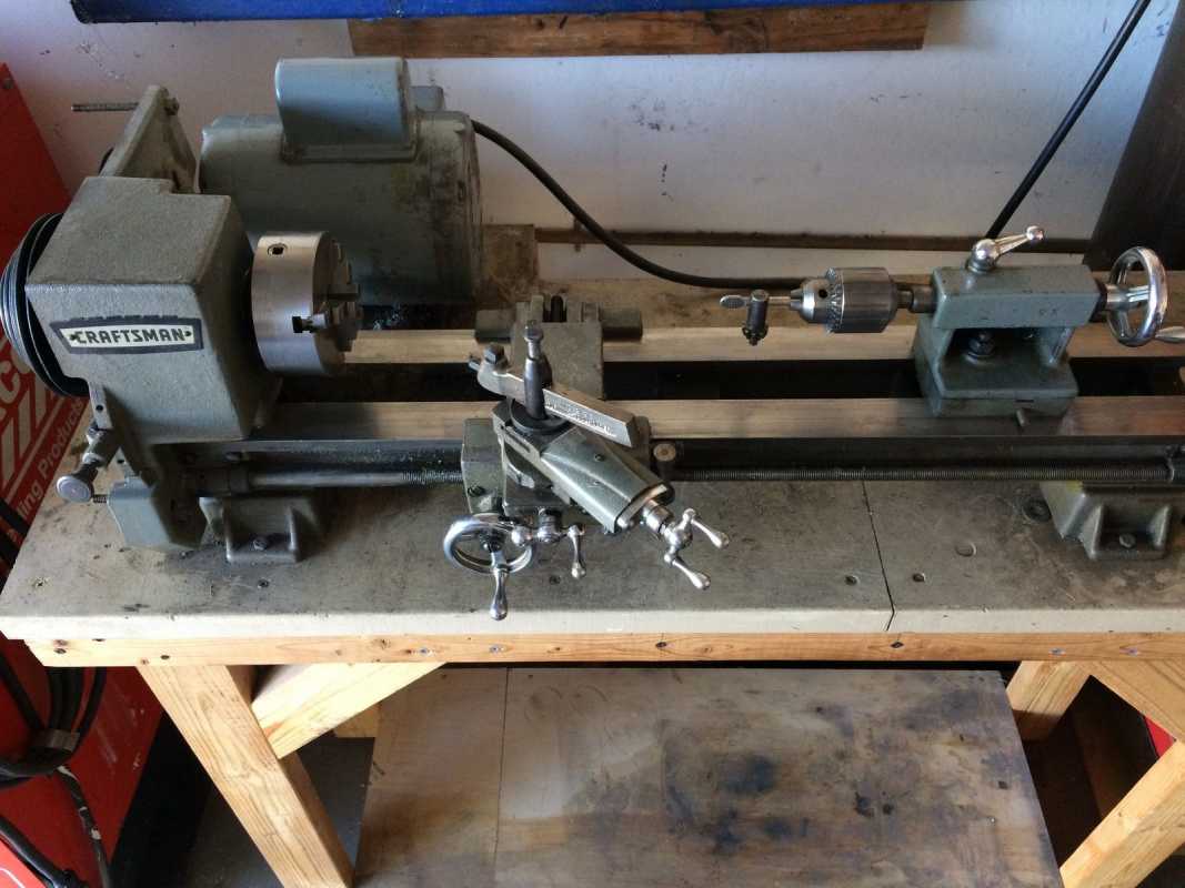

Kawboy's going to be deadly now. Just bought a baby lathe, big enough to fit the camshafts in. I'll modify a tool post grinder to fit the lathe and grind my own camshafts. THEN we'll also get around to doing the camshaft drive chain gear modification to allow adjustment of the camshafts. Now I'm getting back into my old life style. Looking forward to some serious intellegent modifications. Yipee !!
