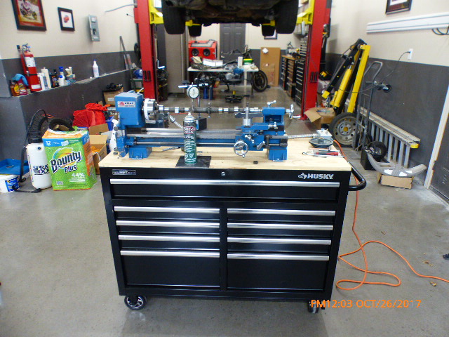

As I suggested, I will tool up my baby Altas Coulson lathe and make a camshaft profile grinder and grind my own camshafts. to do this I will have to make up a master for the profile grinder to follow. Quite often, if a machine shop doesn't have a master for the grind you want them to put on your camshafts, they will have to custom make a profile for your job. Anyone in the business can do this and you pay them to make the profile (usually $200) and they get to keep the profile. Usually they will copy a camshaft that's close to your spec, and then tweak the profile by hand. Or if there's a cam out there with your spec and you can get your hands on it, they can profile off of it. In my case right now, I'm out of luck. There is a camshaft for a VW GTI with 270 duration and .350" lift, but I haven't got one and I'm not about to buy one either. So, I decided to set up one of my 6 intake camshafts and map it out to see if I could use it to make the profile.

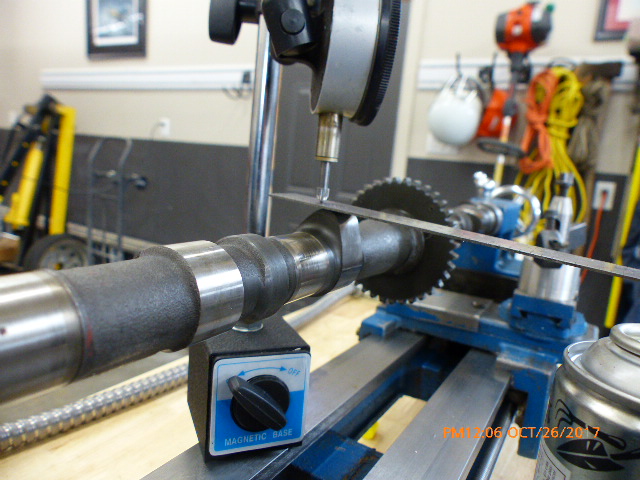

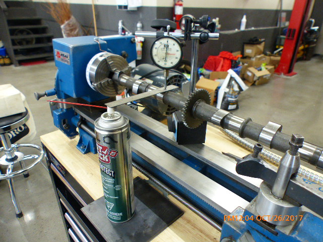

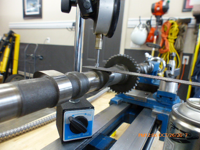

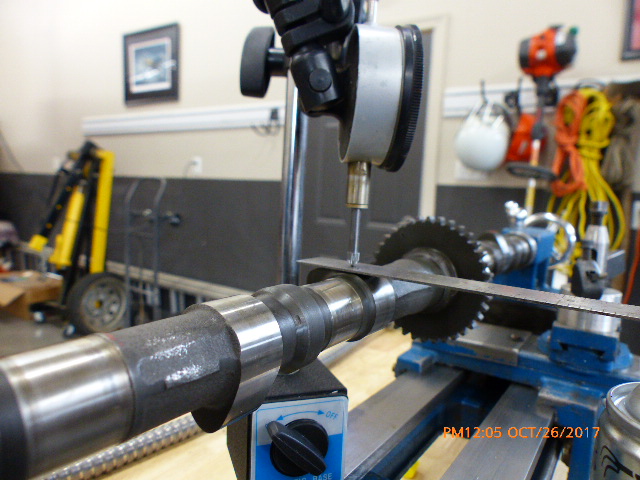

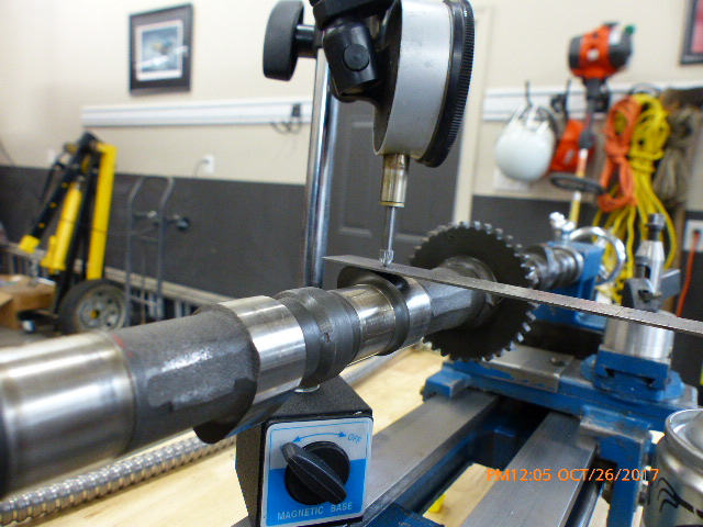

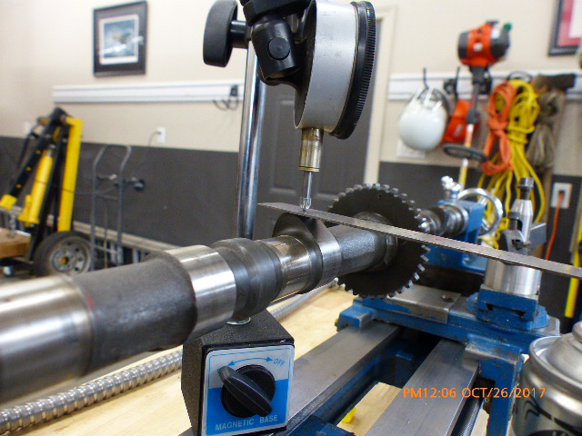

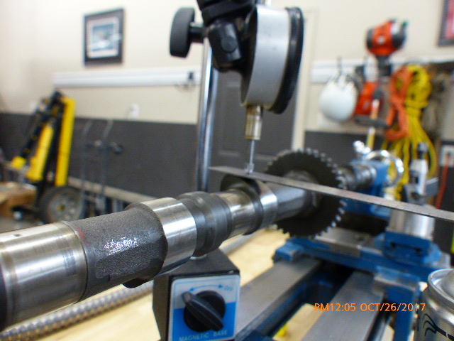

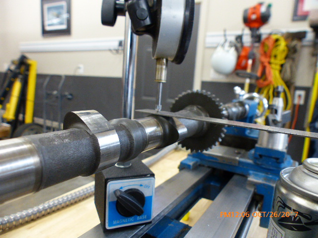

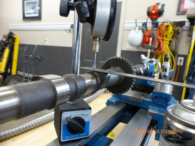

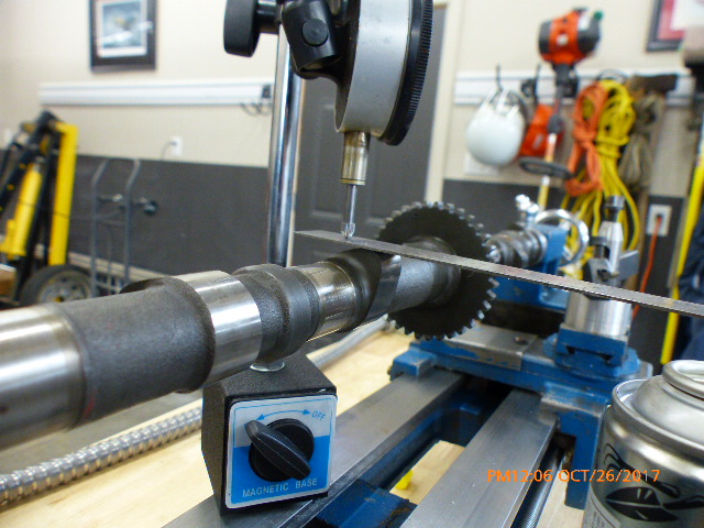

So here's my baby lathe with the cam chucked up and a mag. base dial indicator set up. The aerosol can and the 6" scale are set up to replicate the shim bucket because, as the cam rotates around the contact area on the cam actually swipes across the face of the shim bucket so you can't just indicate to the cam. The readings will be wrong. You'll be able to see what I'm talking about in one of the later pictures.

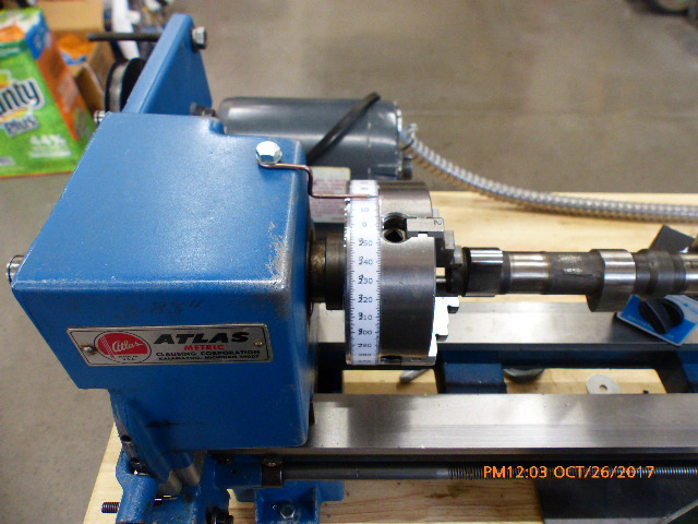

I needed to be able to degree the camshaft as I took readings, so I went to a website ( www.blocklayer.com/timing-tape.aspx ) and created a timing tape to fit my 100mm chuck. I also drilled a hole and tapped for a 6mm X 1mm bolt in the headstock of the lathe and then fabricated up an indicator needle that works with the timing tape.
The camshaft was setup at timing top dead center with the timing tape at 0 degrees and I started mapping out the lobe on #4 cylinder. What i discovered was that the lift on the lobe reached .005" at top dead center #4 when it should be 20 degrees before top dead center and finished 170 camshaft degrees later which is equivilant to 340 degrees of duration instead of 270 degrees of duration. WTF !!! Believe me, I checked everything 3 or 4 times. If I had installed this cam and set the shims at .005" the intake would open 20 degrees late and close 70 degrees late. REALLY ?? How can one explain this phenomenon?

Hopefully you can see why I had to use the 6" scale to mimic the cam follower. This is not easy to see when the cam is in the head but you can see how the cam lobe is wiping across the scale like the head of a wooden match when you try to strike it.
