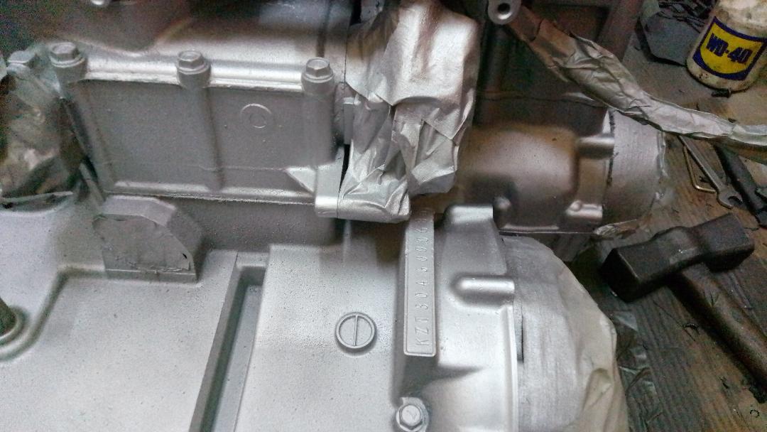

Just something to think about and do your research.
Some "High Temperature Paints" have ingredients to dissipate heat and some have ingredients to contain heat. Anything listed as an engine enamel will have properties to dissipate heat.
I've been doing a fair bit of research on "coatings" at  Cerrakote  and if you follow the "Shop" tab, then "Coatings", then go down the left side, they have a tab called "Special Attributes". You'll find coatings with either high thermal emissivity (the ability to give off heat), or low emissivity (the ability to contain heat)
KawaBCN, You have selected a high temp paint that has the ability to withstand 690 deg C. and that's in the range of exhaust header paint and I wonder if it's able to dissipate heat like what you want. You need a paint that will dissipate heat from the crankcase because there's no oiler  to cool the oil
This is the review of the technical sheet of the paint I bought.
CHARACTERISTICS
- Very fast drying.
- Good hardening.
- Good flexibility.
- Scratch resistance.
- Good adhesion.
- Does not contain lead.
- High covering power.
- Color durability.
- Ease of application and repainting.
- Thermostability. Resistance to high temperatures above 690ºC.
- Adheres perfectly to other anti-heat paints.
APPLICATIONS
Indicated for parts or surfaces subjected to different stages of thermal shock.
- Industry - Maintenance - Stoves
- Boilers - Fluid conduits
- Automotive. Engine blocks, exhaust pipes.
INSTRUCTIONS FOR USE
- Shake the spray very well before use, approximately one minute after
hearing the noise of the mixer.
- Apply on clean and dry surfaces. On rusty metal surfaces:
Remove corrosion with a wire brush.
- Apply in thin layers for best results, always better
three thin coats than one thick coat, repaintable after ten minutes with
the same painting.
- Do not apply to connected equipment and use in well-ventilated areas.
- Request security sheets.
PHYSICAL CHARACTERISTICS
Binder Type: Silicone Resin
Color: Black, Silver
Gloss: Matte <10%
Touch dry (ASTM D-1640 ISO 1517): 10'
Total drying (ASTM D-1640 ISO 1517): 20'
Dry layer thickness (ASTM D-823 ISO 2808): 15 μ/layer (2 passes)
Adhesion (ASTM D-3359 ISO 2409): 3B
Theoretical performance (continuous painting): 2 m² in 400ml aerosols
0.75 m² in 150ml aerosols
Diluent: Aromatics
Product life: (Properly stored) 5 years
Repainting: After 10'
Heat resistance: 690ºC
Application conditions: Minimum ambient temperature 8ºC
Surface temperature of 5-50ºC
Max Humidity 85% R.H.P

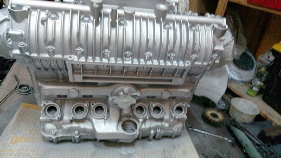

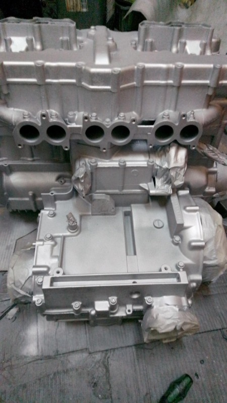

The painted engine already looks better.
If I can't start the motorcycle, I will place it as an ornament in the living room of my house, between the grand piano and the fireplace.
