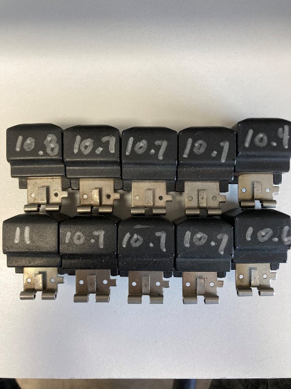

Weigh the floats.. I have an OEM set somewhere, perhaps Scotch can tell you what his brass floats weigh. Too heavy = minimum shutoff capacity.
