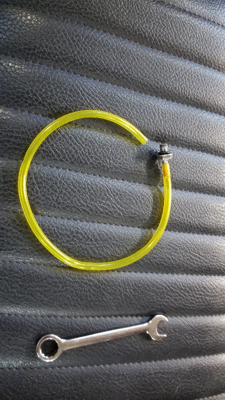

Thanks for those links Guys. I'll order some drain screws from Kawasaki. In the mean time, I drilled out a drain screw from one of my spare carb sets and soldered a piece of 1/8" copper tube into it thus:
At this point I only have one so I checked the fuel levels three times and surprisingly, at least to me, the 1-2 carb wasn't the highest.
The 1-2 & 5-6 carbs were holding at 1/8" below the top of the fuel bowl and the 3-4 carb was reading right at the top. All three are too high.
The spec is 5mm (a shy 1/4") to 8mm (a proud 5/16") below the top of the fuel bowl. I did this with the bike of the center stand, carbs still mounted.
So still no answer why the #1 cylinder runs so rich on so many 1300s.
Could it be that fuel siphons from the center and right side carbs when the bike is on the side stand? This might cause the 1-2 carb to be flooded.
No, that's not likely it'd have to flow back up through the float valves.

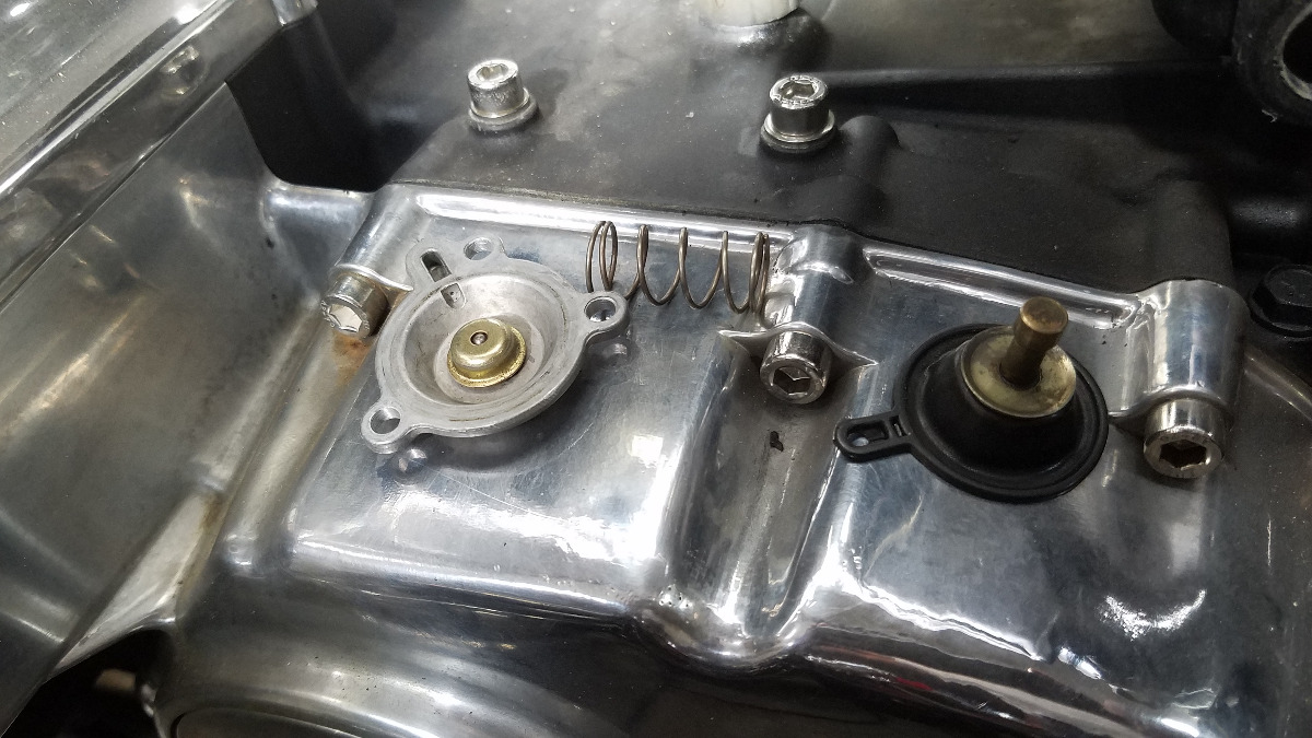

I haven't yet pulled the carbs but I did remove the cover from the deceleration enrichment diaphragm on the 1-2 carb. I've always been concerned that this enrichment system contributes too much fuel. Here's a pic of the various parts after I removed them:
The cylindrical plunger, on the right, fits into a hole in the carb body and supposedly blocks off a passage that adds fuel whenever the intake vacuum rises high enough. My impression of the fit between the plunger and the hole in the carb body is that it's way too loose. I actually took a video of the plunger wobbling in the hole it's supposed to seal but it wasn't of good enough clarity to post it.
One of the modifications I made to my own 1300 was to plug up the holes in the carb throat that admit the fuel for this enrichment system. I know that others have chosen to defeat this system by interrupting the vacuum signal to the enrichment diaphragm but doing so does not address the loose fit I found between the plunger and the carb body. I'm thinking that even when closed off that loose fit allows excess fuel into the carb throat.
I'll definitely be plugging these vents as I get further into these carbs.
