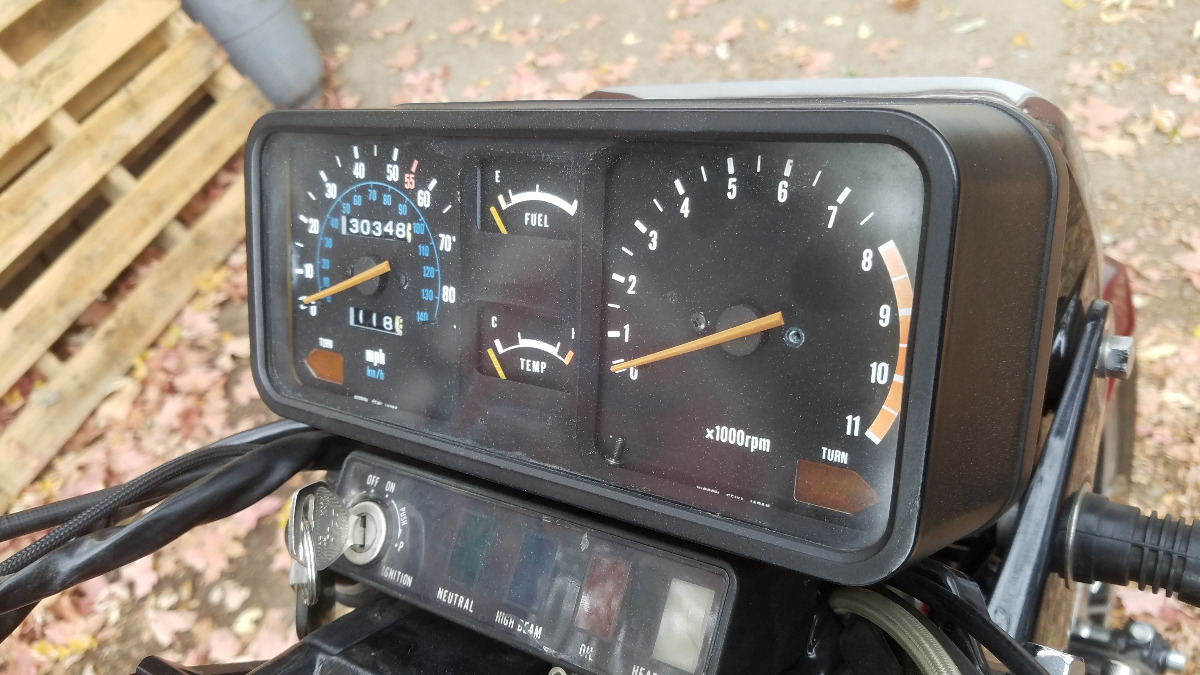

I'm thinking that I'm closer to the end of this project. I noticed that one of the screws that hold the faceplate onto the speedo/tach has vibrated out of it's hole.
Do any of you know how to disassemble the speedo/tach?
Thanks in advance
Thanks in advance

185633510157 is my eBay item number for the needles. There I show with photos and give instructions on how to open the gauge cover witout removing it from the bike.
