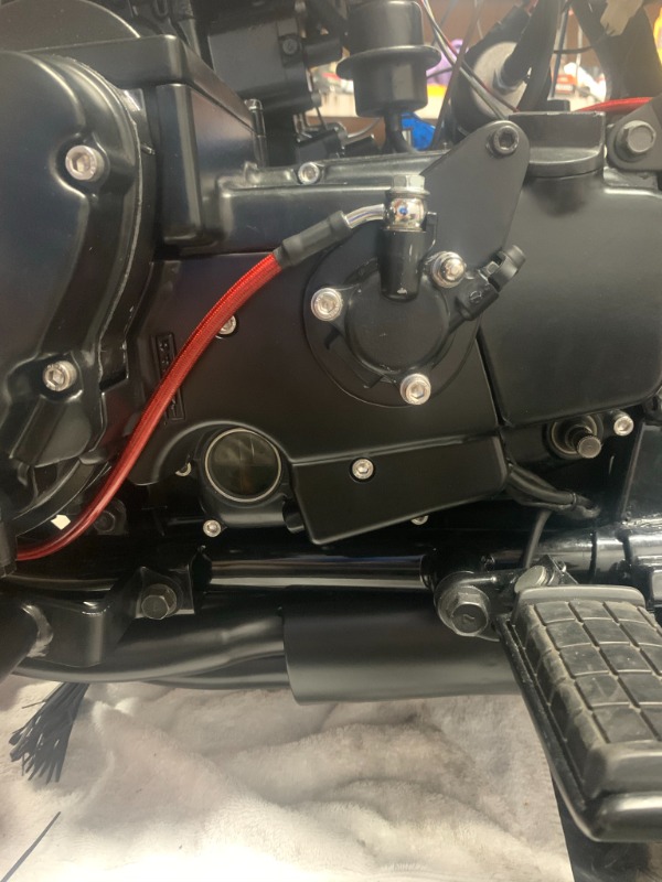

Received back some parts from powder coating
This is the final look of the hydraulic clutch
didn't ride it yet but it look to be functioning good

Looks like a nice clean adaptation of the KZ mod for the ZN engine. Interested in hearing how you like it after riding the bike.

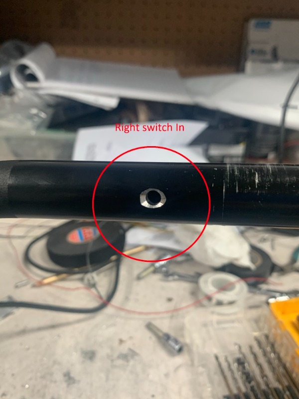

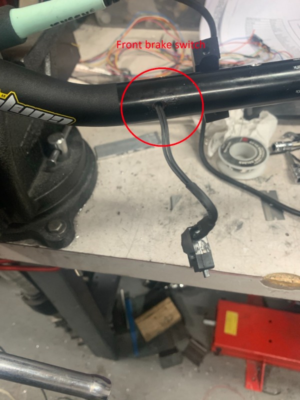

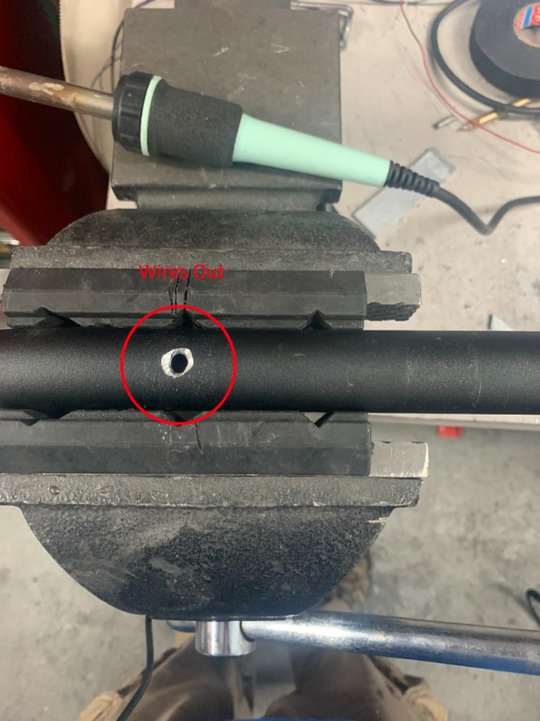

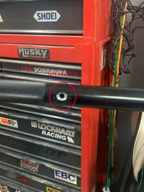

In order to use the M-switches I had to drill 4 holes in the handlebar
1. Left side switch
2. Right side switch
3. Right side for brake switch
4. Wires out from handlebar

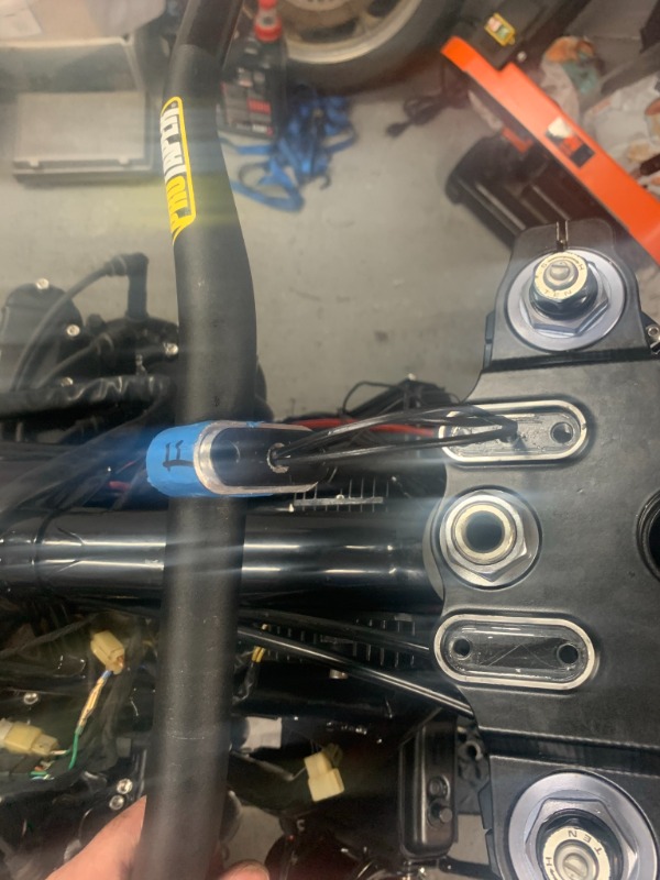

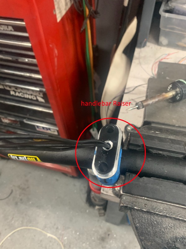

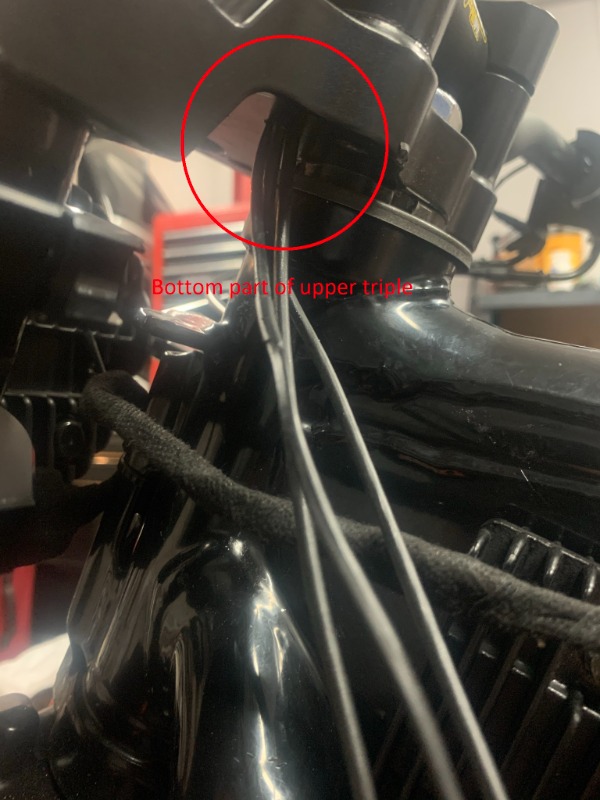

I ran the wires out of the bars through raiser and upper triple
I am happy with the end results and one step closer to completion

Kawboy wrote: Looks like a ton of work. Too bad they don't make wireless switches :whistle:
It wasn't so bad, took me more time to undo the previous install then doing again
it will be much easier to do it on regular bars, they are thinner and easy to run the wire through them
